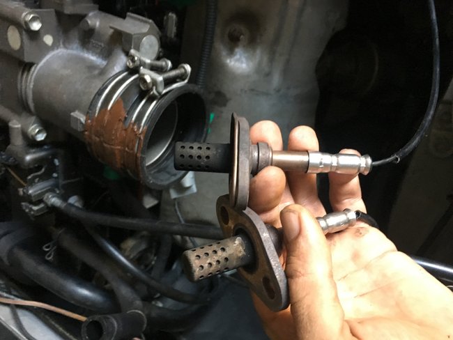

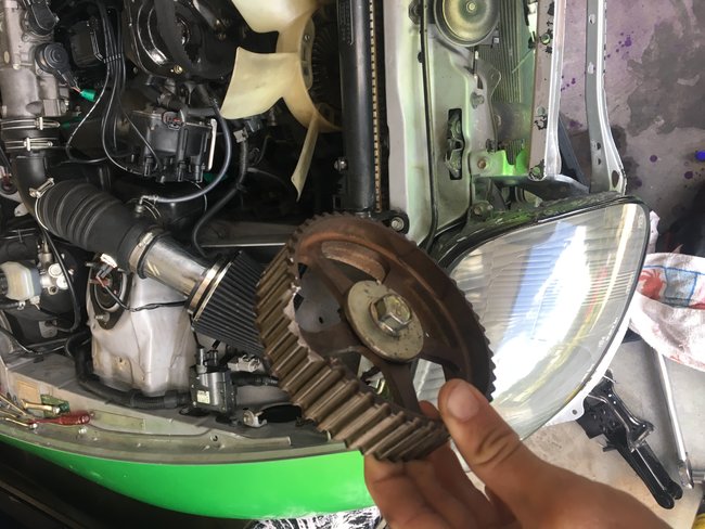

Need help/advice Toyota Supra 1993 GE.
I will keep the story short.
Blew head gasket and warped head, replaced both and also replaced spark plugs and leads and the car runs perfect no leaking and does not miss or any power loss.
Check engine light with code 25 engine running lean happens each time I drive it and warms up and each time I turn the car off and turn the car on again and start driving for about a minute or so the code comes back on, but still no missing or no power loss. Cleaned the o2 sensors overnight in petrol then drove the car for about an hour to get replacement o2 sensors. Removed the old o2 sensors and one is black while the other looks normal. Drove it home and took the new o2 sensors out to check em and the same problem one looks normal and the other one is black.
Still getting the running lean code so decided to check all vacuum lines for air leaks and did not discover any leaks. Just hunting for some advice please, because I am close to hitting the wall and running out of ideas.

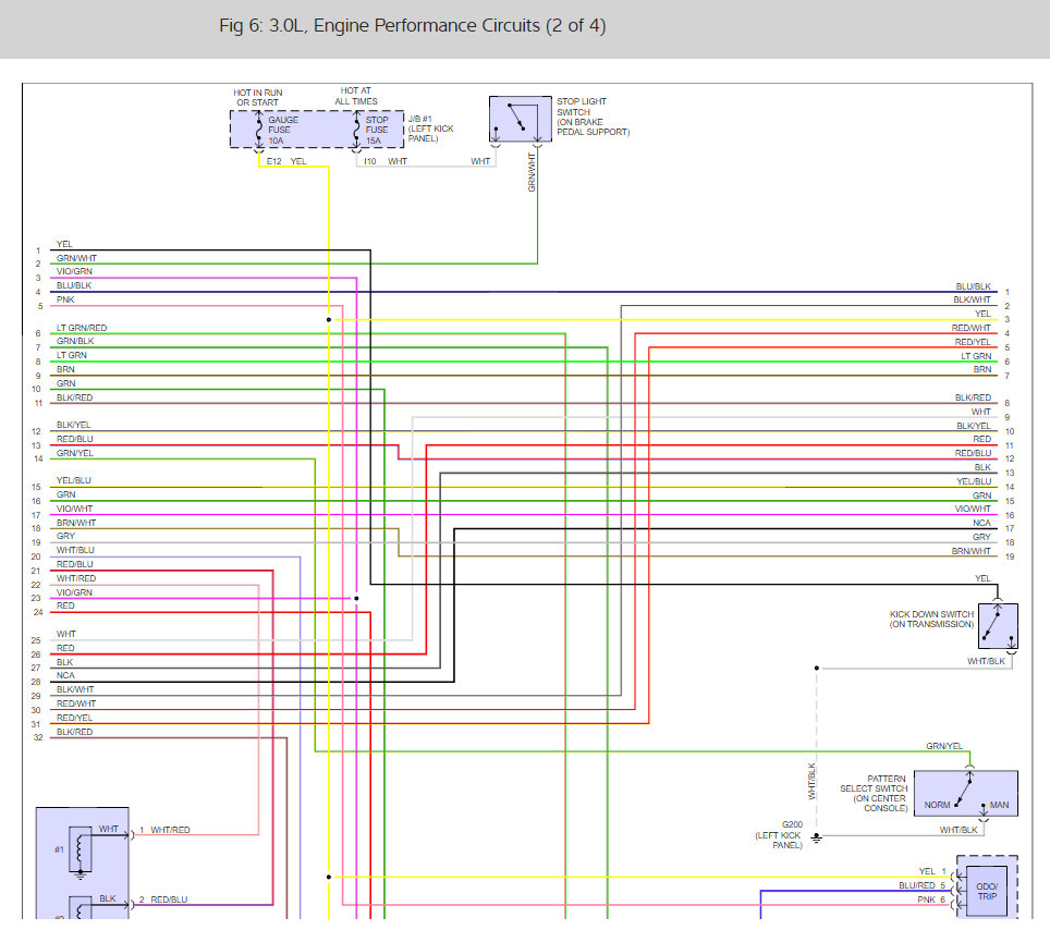

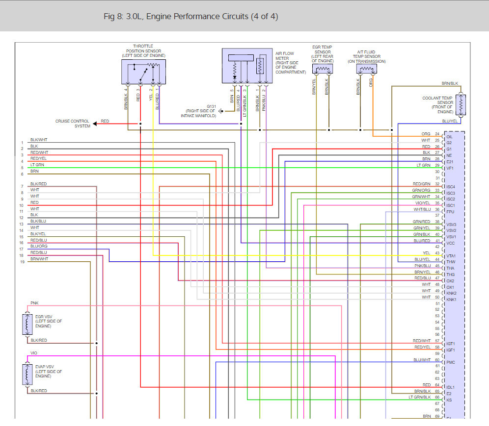

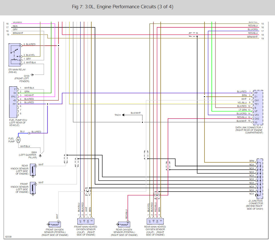

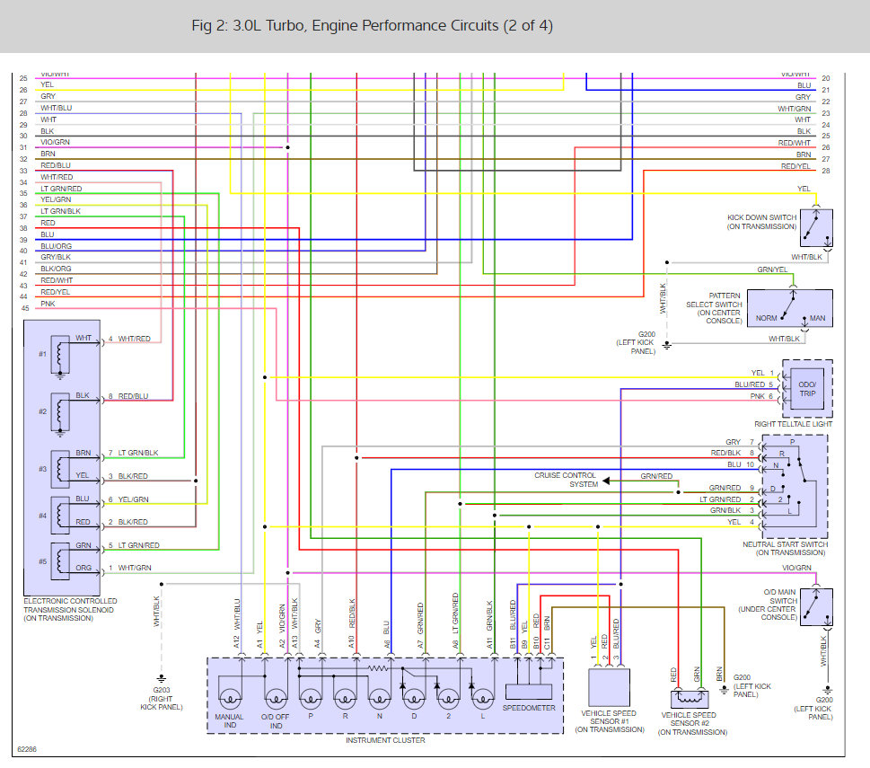

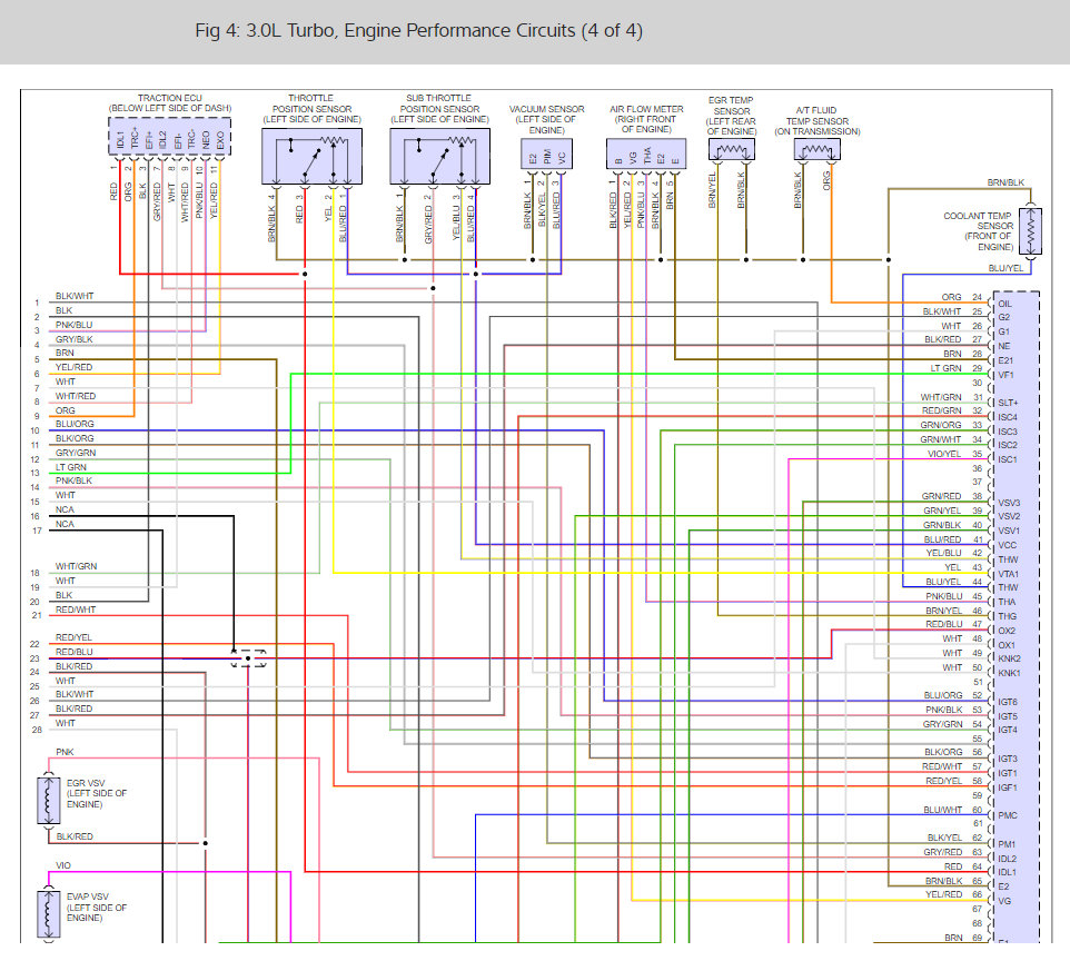

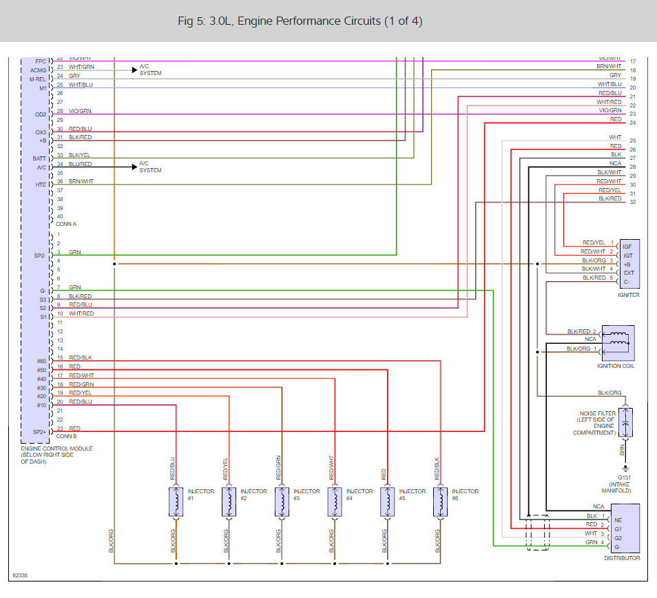

KEN L
  • MASTER CERTIFIED MECHANIC
  • 55,244 POSTS

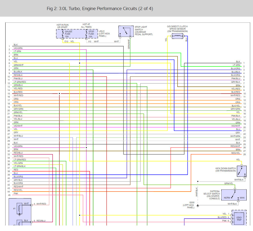

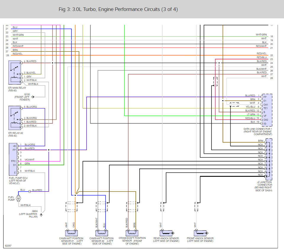

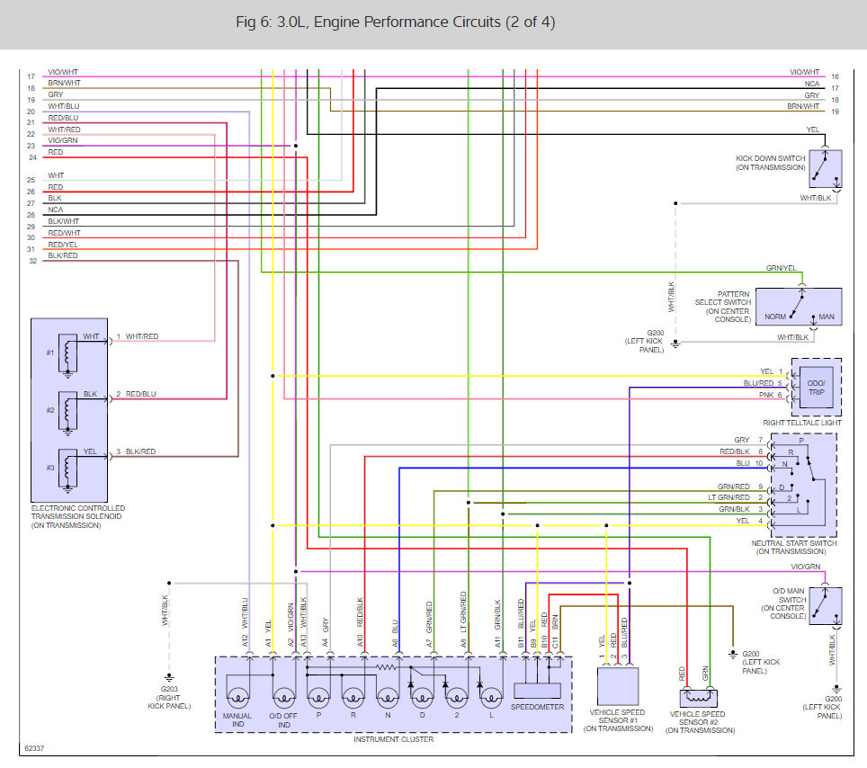

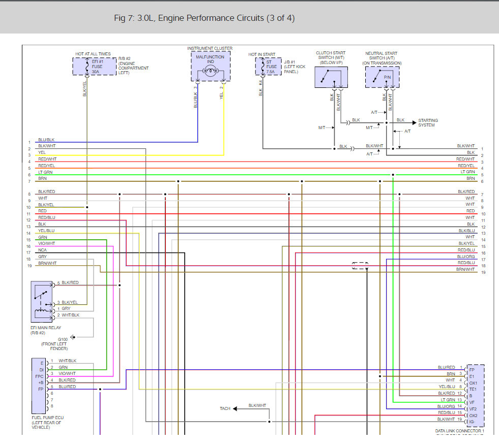

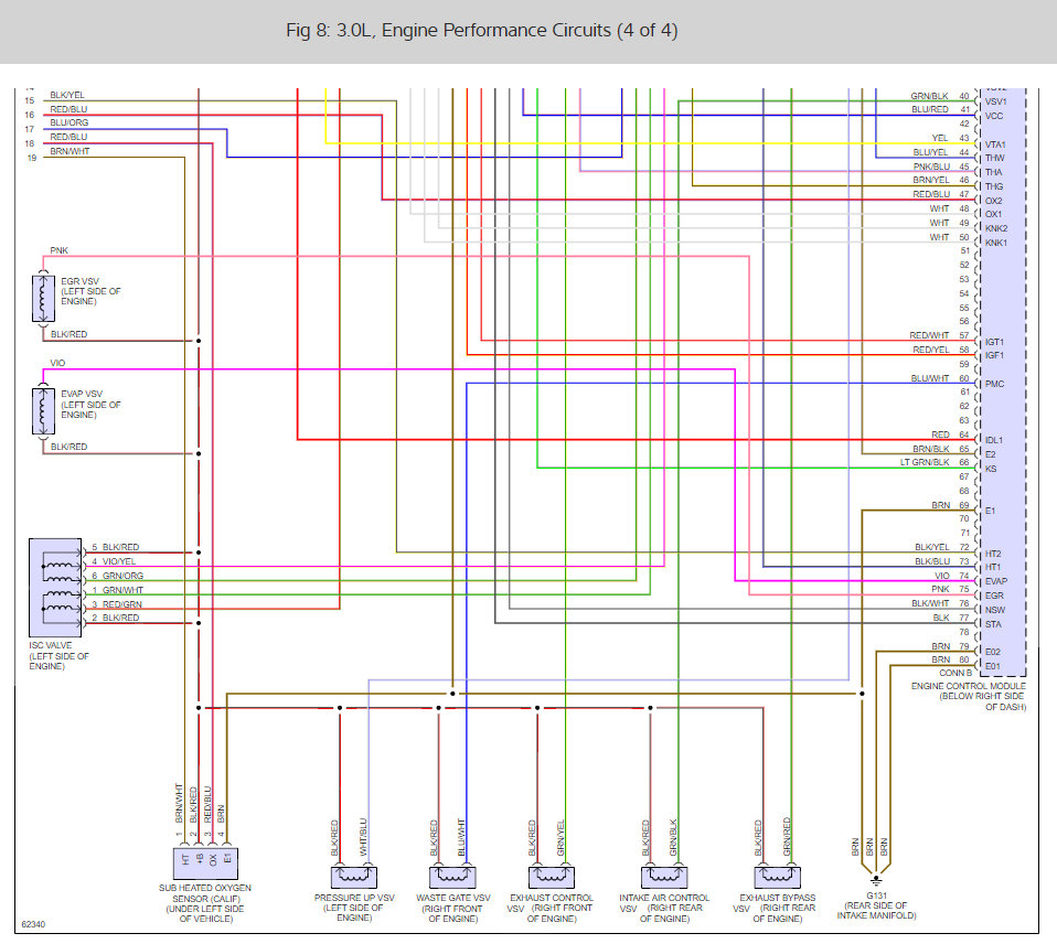

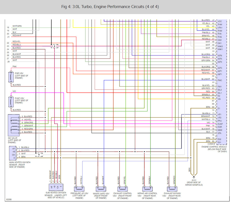

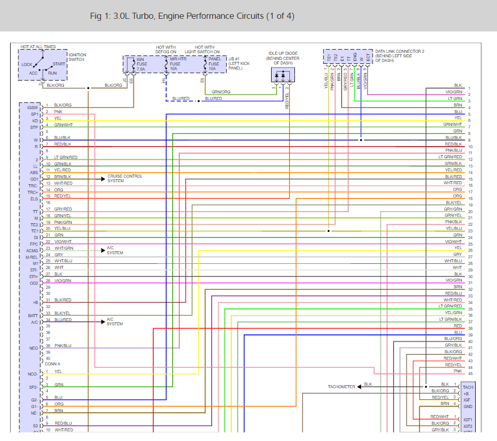

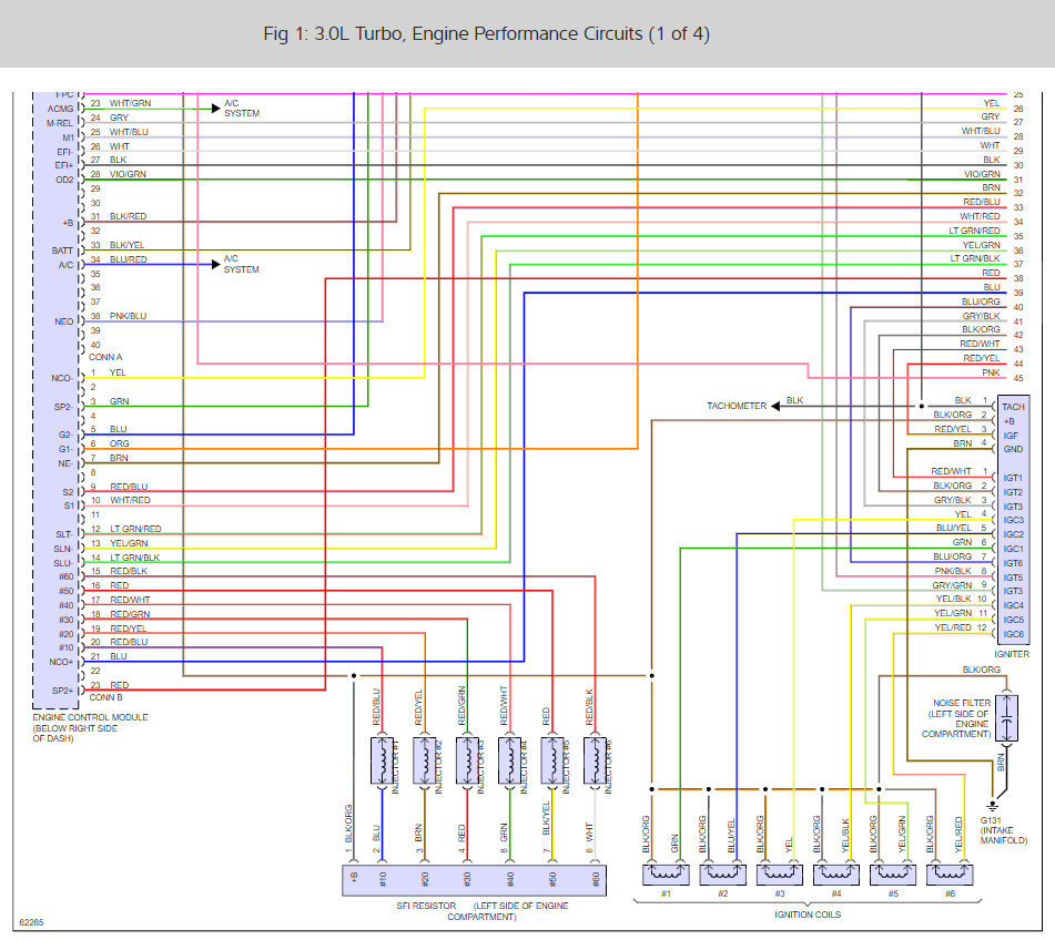

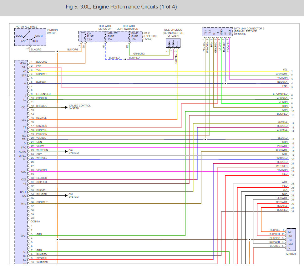

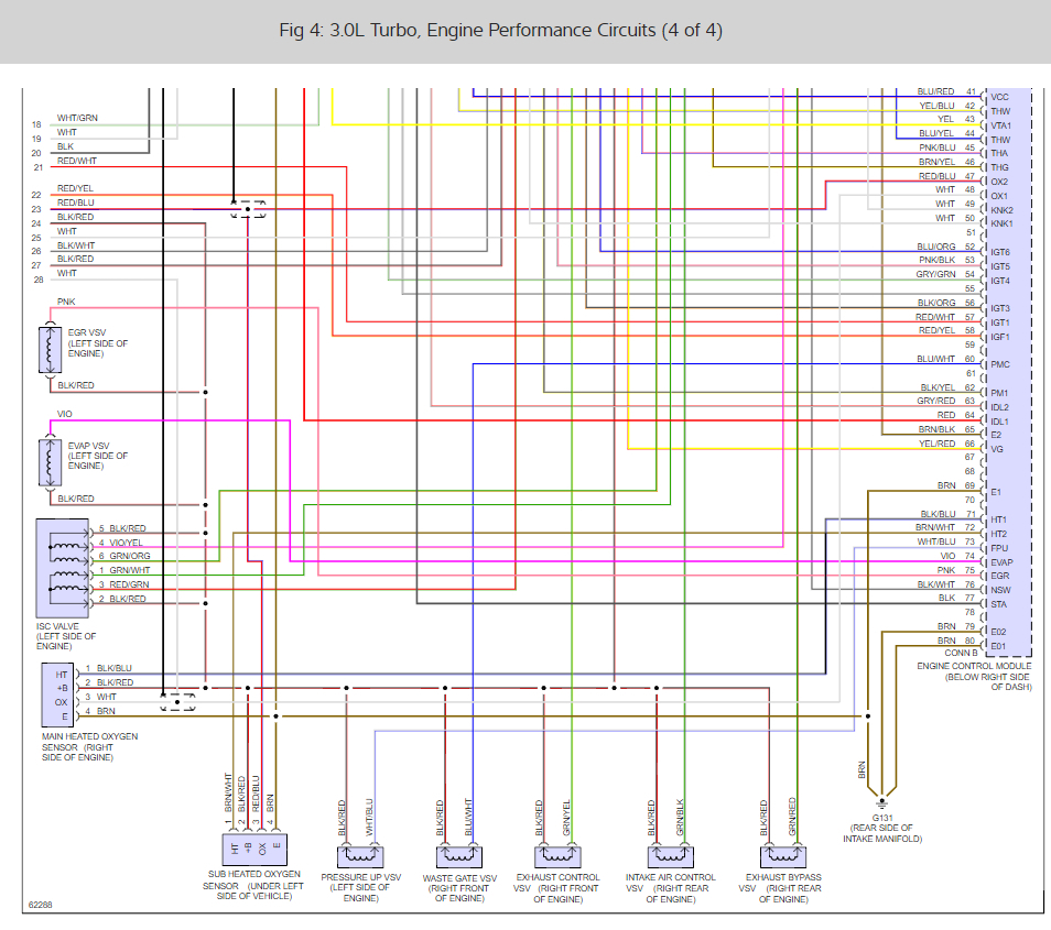

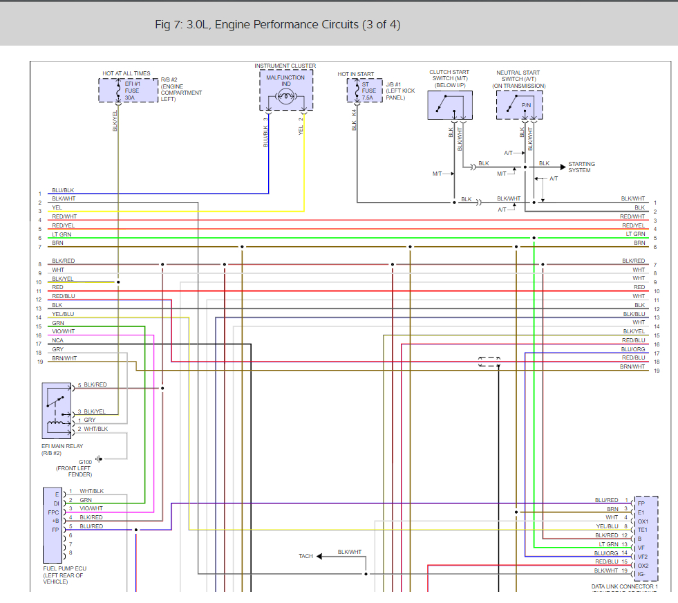

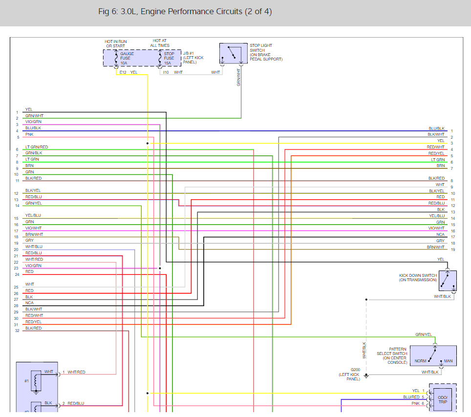

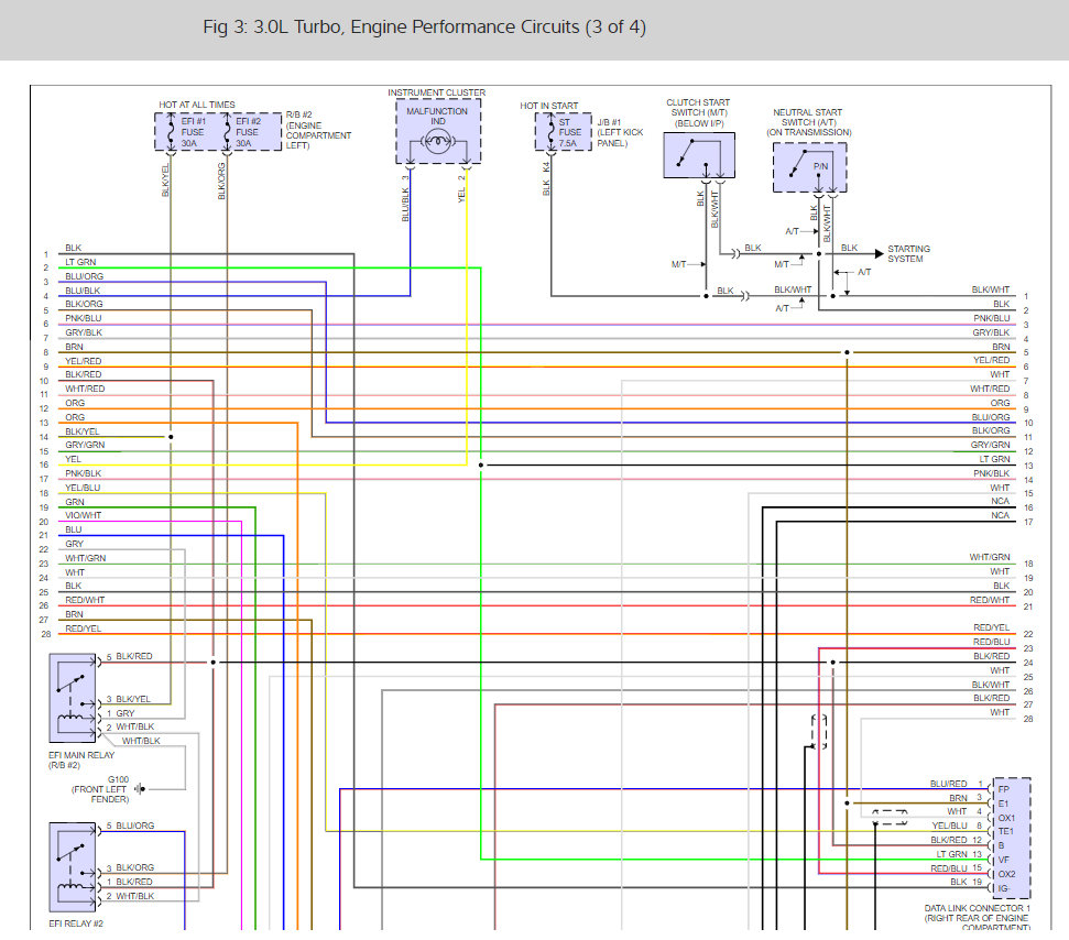

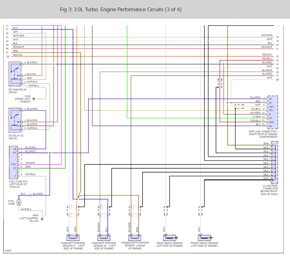

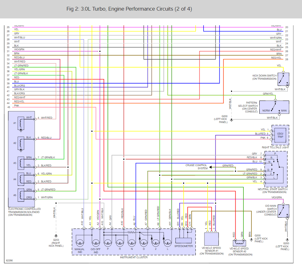

It sounds like you are on the right track. Here are some engine wiring diagrams (below) and a guide to help you do some testing to confirm the problem.
I gave you both turbo and non turbo engines
Please let us know what happens and upload pictures or videos of the problem.

Ok progress. The 2nd o2 sensor had 0 volts and was dead that for both the old one and the new one replacing it. Turned out to be not the o2 wiring itself but the o2 connector wiring back to the ecu that had some wires broken on it, now both o2 sensors are working and volts on both sensors. I conducted a vacuum test using a vacuum/fuel pressure tester and tested every vacuum port and all were showing 21hg which is in the green zone on the gauge so there's no vacuum leak on any part of the intake atleast. I reseted the ecu and took it for a drive but code still pops up after warming up and driving it down the road. I have a fuel injector sealer kit coming in tomorrow so I will be replacing all seals on the injectors so hopefully that sorts the problem out and also will conduct a compression test. I don't think spark or fuel is the problem due to no missing at all or no power loss but I don't know. Tomorrow I'll replace all injector seals and do a compression test then I don't know if it doesn't fix the code

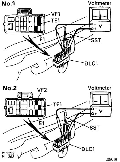

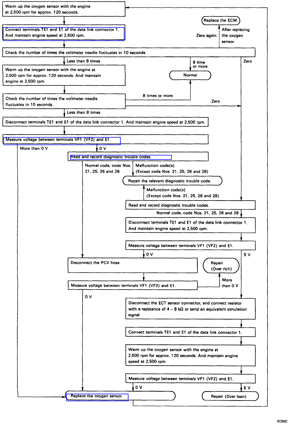

Factory test -
Connect the positive (+) tester probe of a voltmeter to terminal VF1 (for No.1) or VF2 (for No.2) of the data link connector (DLC1), and negative (-) tester probe to terminal E1.
Then follow the chart included.

Mine is a 1993 model non turbo and its old school single wire o2 sensors, I did that test and that's how I discovered that one o2 sensor (the engine wire to it ) was dead and not producing any volts at all I then followed from the manual how to monitor the volts using ox1 and ox2 on the diagnosis port to monitor each o2 sensor

I don't have any of those types mine looks ancient and is a 2 wire one, the clip is missing must of been broken by previous owner so it's pretty much 2 wires each connected to a metal clip that clips directly onto the sender where as the wires would be connected to the female plug to plug onto the sensor. The second picture is the best photo I have ATM where you can see on the intake that the wires directly connect to the sensor itself not through a female/male plug connectors so I might fix that up but at the same time wouldn't that set off a code straight away, the code comes on after around 1minute of driving when the o2 sensors warm up and start operating, one o2 sensor works fine volts jump and and down but the second one doesn't it stays high and doesn't move, I tried to rewire a few days ago and it started jumping like the other one but has failed again so I will have to really cut and connect fresh wires together and solder it and see what happens
