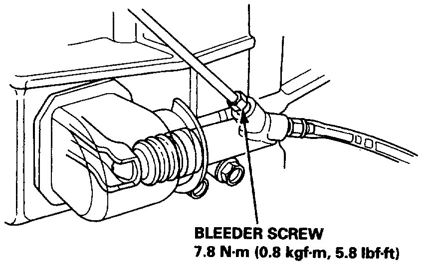

I recently changed the clutch and flywheel in my vehicle and upon reinstallation, I purchased a new battery to be safe. I noticed at first that the clutch pedal "pops" down to the floor board with absolutely no pressure, and in order to get it up, I have to apply light pressure from the back to "pop" it back up towards the driver.
So, with the clutch pedal (with no pressure) depressed, the car cranks and cranks, but will not fire up. Starter is ok, new battery, alternator is fine and everything power wise worked great before the install.
I probably need to bleed the slave and master cylinders, but with absolutely no pedal pressure, the system won't seem to pressurize after pumping and pumping. Would this be a reason it wouldn't start?

The pedal going to the floor isn't the cause of the no start.
First, here are directions for bleeding the slave/clutch master cylinder: See pic 1
Bleed the clutch hydraulic system.
- Attach a hose to the bleeder screw, and suspend the hose in a container of brake fluid.
- Make sure there is an adequate supply of fluid at the clutch master cylinder, then slowly pump the clutch pedal until no more bubbles appear at the bleeder hose.
- Refill the clutch master cylinder with fluid when done.
- Always use Genuine Honda DOT3 Brake Fluid. Using a non-Honda brake fluid can cause corrosion and decrease the life of the system.
- Confirm clutch operation, and check for leaking fluid.
