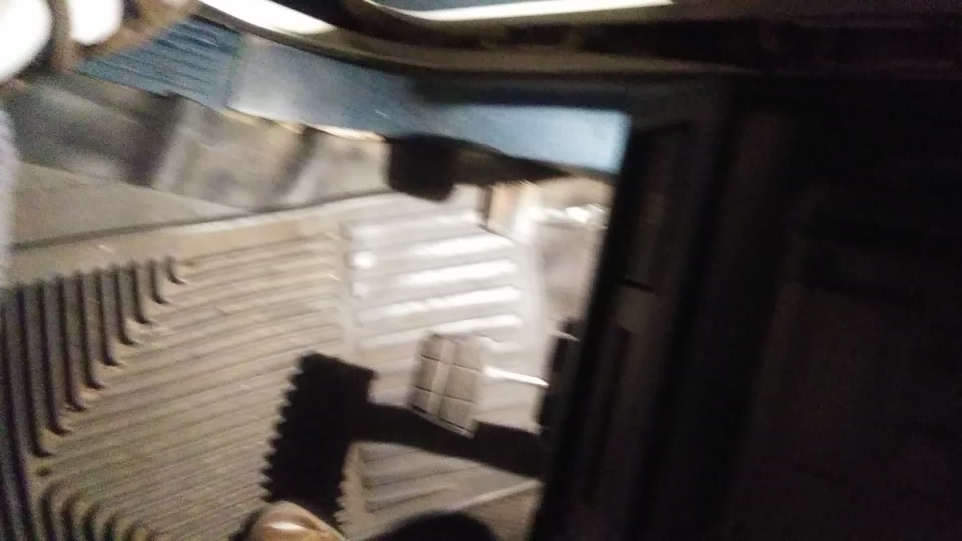

Can you please shoot a quick video with your phone so we can hear the noise? That would be great. You can upload it here with your response.
Friday, September 11th, 2020 AT 6:26 PM
RVG111
  • 6 POSTS
Throw out bearing? Clutch works fine, it's just really loud, louder than video when you stand outside of truck. Do you recognize the sound? I've heard bearings go out, I don't know just sounds weird to me. It's been doing it for about 2 years.
Friday, September 11th, 2020 AT 7:19 PM
Sorry. You attached a picture not a video. Can you try one more time? Thanks
Friday, September 11th, 2020 AT 7:33 PM
RVG111
  • 6 POSTS
Crap, I'm not any good at sending attachments I'll try again.
Friday, September 11th, 2020 AT 7:51 PM
RVG111
  • 6 POSTS
As long as that took to upload I wouldn't be surprised if it's the whole gallery rather than one video, don't know what I'm doing. It's taking forever to upload, I don't know why.
Friday, September 11th, 2020 AT 8:40 PM
Okay. That is a good video. This noise is most likely the throw out bearing. You are correct, it does not have the normal sound of a bearing but when you press the pedal just past the engagement point and it is making noise like you are, that is the throw out bearing putting pressure on the pressure plate.
