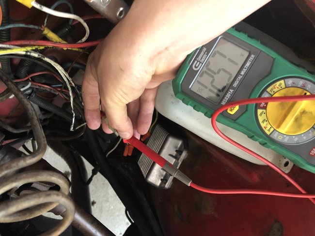

Photos attached.

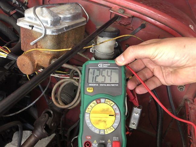

Photo 1 - key on. Reading of 12.65.
Photo 2 - key off. No reading.

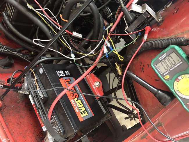

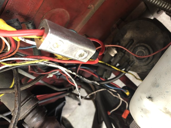

Photo 3 - splice at jumper. Left small wire goes to starting solenoid. Right small wire goes to coil.

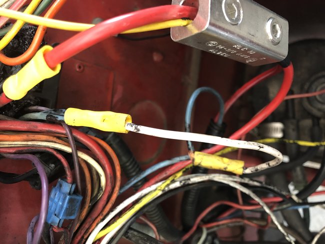

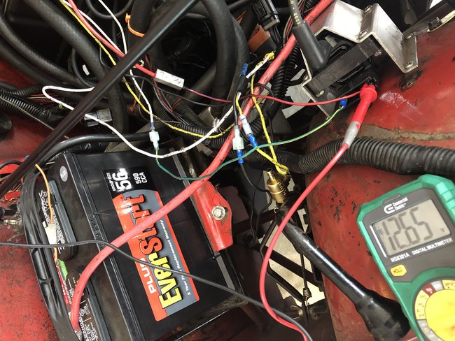

Photos 4 - splice at firewall by driver. Top red wire is power in. Bottom left leaving red wire is jumper. Bottom right leaving red wire is to ICM.

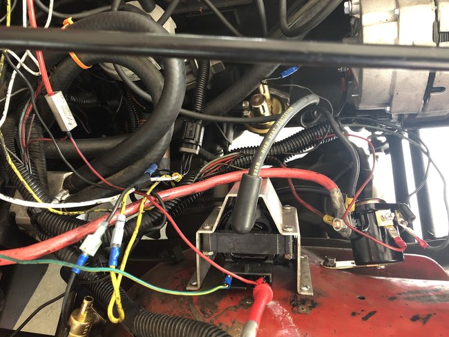

Photo 5 - key on. Reading at splice to jumper and ICM. Drops to zero with power off.
Photo 6 - key on - reading at red ICM wire. Zero with power off.
Photo 7 - two splices. Bottom splice - blue wire from the right is from the ICM. Splices to white wire. White wire splices to two blue wires coming through fire wall.

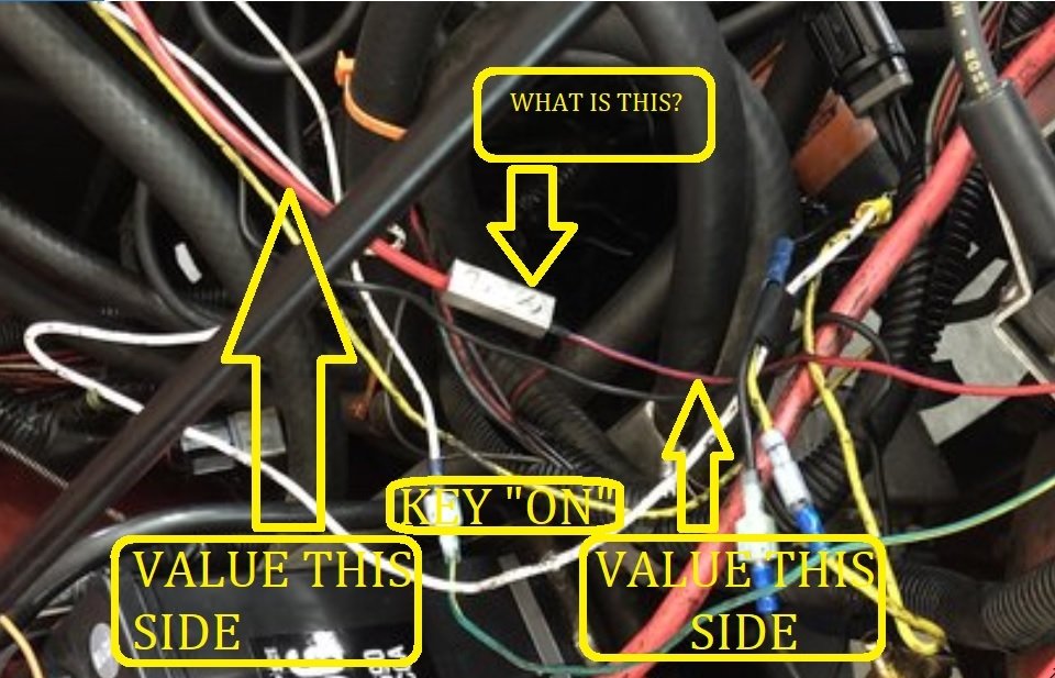

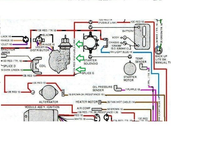

As you can see, 'splaining wires positions is a hard task to do.
I may have you draw a diagram or I will make you a drawing and you connect the "dots" with wires and where they go.
I'll jump on that soon!

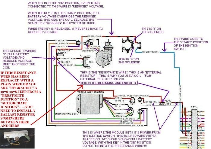

I came across this. (Picture 1)

Yeah it is tough to explain. Wish you could see it with your own eyes! That aluminum thing is a splice. Value is roughly the same on each side of it. This splice is where the two small wires leave (to the right of your photo), one heads to solenoid, other heads to coil.
What are some other values I should be looking for?
So strange - started yesterday briefly now won’t budge.
Sunday, April 28th, 2019 AT 11:51 AM
CJ MEDEVAC
  • 11,004 POSTS
I see what the mysterious block is now with the magical pictures, I thought it was a resistor. It is merely a mechanical butt splice. They need to be taped up (re-taped up) to prevent them from touching something and shorting or grounding out.

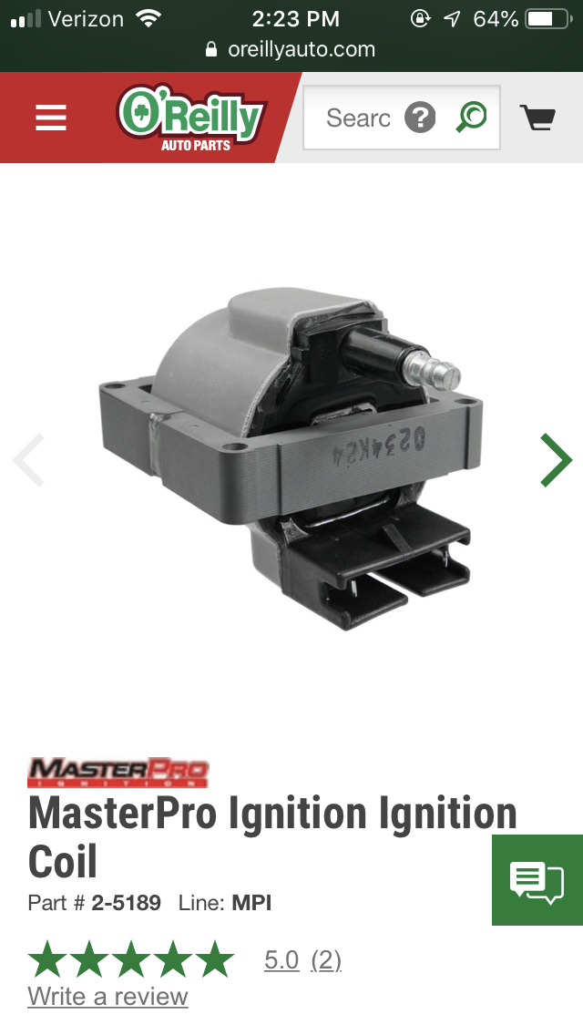

This is a photo of it. The previous owner said he did a TFI upgrade. It is a mid 90’s Ford coil.
Another note. I put in a new ICM yesterday when it started running. Not sure if that had anything to do with it.

I done a bunch of researching of that coil.
It will work with a 1.8 OHM ballast resistor.
Seems few places that have ballast resistors do not boast on what the resistance rating is.
I finally found this one:
https://www.autozone.com/ignition/ballast-resistor/duralast-ballast-resistor/116673_0_0
You can also take your voltmeter with you and maybe find one with right 1.8 resistance.
Many times the online (and local parts) stores want you to give the application. This would maybe work if the wiring was not changed.
Yours is now in the twilight zone, everything for your ignition is special and not OE. It's best to get a zip-lock bag and tear the labels from the boxes and stick them in the bag. In the future you will be able to produce a part number for what you need.
Example of mine
I have a '77 CJ-5, originally it had a "Prestolite Ignition System". The '77 did not have a resistance wire, and had many quirks and problems with the Prestolite.
I opted to change the ignition to be "Motorcraft" exactly like '79, '80, '81.
I needed resistance (I did not install a resistance wire) I used a ballast resistor, I got a reman distributor for $50, a coil for a '79, new plug wires, and several working ignition modules from an auto salvage yard (maybe $10 for 3) and I poured through the Ford vehicles until I found the correct connectors for the module and distributor. The wires on them were various lengths and had to be spliced to be correct for my application (those wires and connectors were freebies!)
Now if I need something from a parts store for the ignition I tell them I have a '79 w/ a 258 (not a '77) The only thing that is not '79 and is kind of "oddball" is the ballast resistor.
