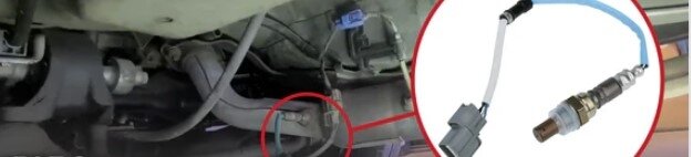

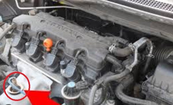

Okay, so looking through service info a little more, the DX is the only 1.7 liter, but there are many variations for this year for some reason, any Oxygen sensors you should see screwed into the exhaust pipe, with a 4 wire connector, on a 1.7 liter engine there will most likely be a front oxygen sensor in the exhaust manifold, but they should all be visible sticking out of the side of the exhaust system all the way down passed the Catalytic Converter.

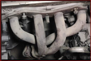

Here's some examples of the front and rear sensors.
Tuesday, December 10th, 2024 AT 11:32 AM

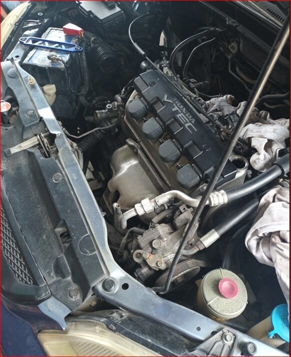

SIMARUN08
  • 30 POSTS
Unfortunately, mine doesn't have one at the exhaust. See pictures attached.
Wednesday, December 11th, 2024 AT 4:04 PM
AL514
  • 5,584 POSTS
Are there emissions testing in your state?
Wednesday, December 11th, 2024 AT 7:25 PM
SIMARUN08
  • 30 POSTS
There is an emissions testing but not seriously taken by the transportation dept.
Wednesday, December 11th, 2024 AT 7:32 PM
AL514
  • 5,584 POSTS
Is there any sensors in the entire exhaust pipe, even after the Catalytic Converter? (The larger sections of exhaust pipe). Im not really sure how or why there would be any oxygen sensors missing from the vehicle. You're in the US correct? Or not?

SIMARUN08
  • 30 POSTS
Have not yet check below the vehicle, I'm not sure if there is.
I'm in the Philippines, one mechanic here told me that 2002 model have no O2 sensor, just wondering though, but 2003 have one at the front near the exhaust.
Wednesday, December 11th, 2024 AT 8:43 PM
AL514
  • 5,584 POSTS
In 2002 they did build a model with no Oxygen sensors, I was surprised to see it, but if you're not in the US, it's different requirements here. We have very strict laws on emissions here. I can imagine without any air/fuel feedback systems in place, it would be more difficult to diagnose rich or lean running conditions. Usually there would be one 02 in front of the Catalytic converter and one behind it to monitor its performance. And set trouble codes for emissions related problems.
