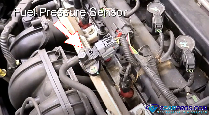

2. Bad Fuel Pressure Sensor: Newer cars are equipped with a fuel pressure sensor which helps the engine computer regulator the amount of the fuel entering the engine, when this part goes bad it can give a P0088 or P0191 trouble code. This sensor is located on the fuel rail most of the time and is easily changed.
