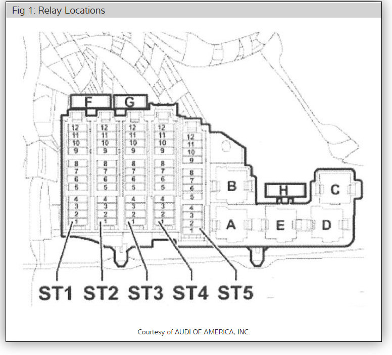

Hi Alex, all 3 fuse panels only list fuses no relays the only relay I can see is in the boot but can't find it listed anywhere it has 643 or 645 stamped on it. I have looked at my hand book they don't list any relays on the car and Audi garages not helpful at all. So thanks for your help and time. Jim

The numbers may not match. Do you have power at the fuses?

Hello Ken, no I have no power to the 4 fuses.

It will be the relay then. Here is the location: Sockets Relay J807 (E) Check out the diagrams (below). Please let us know if you need anything else to get the problem fixed.
