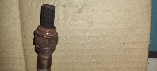

02 sensor
up stream
Sunday, March 2nd, 2025 AT 5:49 PM

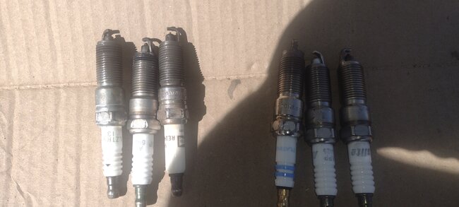

Spark plugs
Sunday, March 2nd, 2025 AT 5:50 PM
KEN L
  • MASTER CERTIFIED MECHANIC
  • 55,130 POSTS
Thank you, do you see the one spark plug that is white? This will be the cylinder that is having the issue. So, it will be low compression, or the fuel injector is not working.
