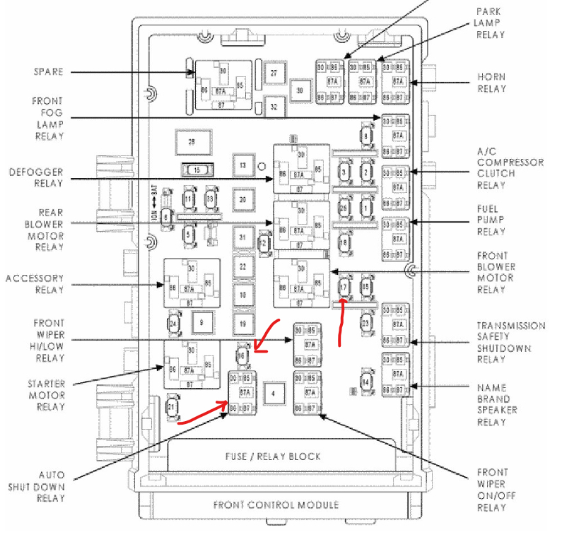

no crank no start, installed new preprogram PCM now it a crank no start. The fuel pump only comes if you jump it, still no start. no spark no power to ignition coil installed new plug and wire no.

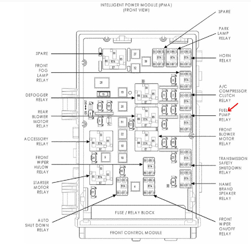

I would also check the fuse # 16 and 17 in the fuse panel under the hood. Also, you might want to try swapping out the auto shut down relay as well. Check out the images (below). Please let us know what happens.

asd fuse and fuel pump fuse has power.

16 and 17 has power .

fuel pump only come on when I ran a jumper wire to fuel pump relay 30 and 87.

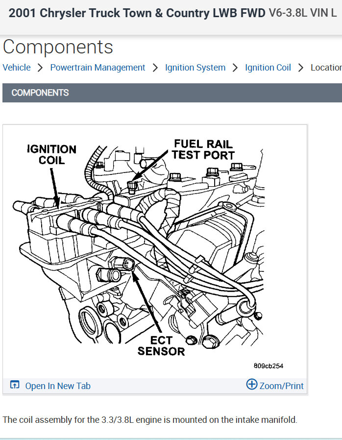

I got spark now finally says scanner 9 sparks I just won't start.

now I'm getting spark at the spark plug but not at the coil.

Do you still have these codes? I have seen the coil pack go bad and cause the intermitted spark issue. I would swap out the fuel pump relay and then clear the codes again. Take a video with your phone and upload it here in your response like an image. Check out the images (below). Please let us know what happens.

i install a new coil I got from Amazon, still same getting RPM and no start. I smell a heavy fuel smell in the engine area.

when checking for spark car started for 30 second after I tighten down the coil more, the coil was a little loose.

So when you tightened the coil it stopped running? If so, the coil sounds bad, and I would replace it.

I think is something with the add relay, it doesn't crank when fuel pump or ASD relay remove, I am lost.
Mar 2, 2025 at 12:59 PM
CHRYSLER 01
  • 73 POSTS
ASD relay problem that's what I meant.
