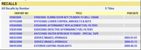

Hey also, it looks like you may have some recalls on your vehicle. The dealer may fix these for free. Please contact the dealer service department, give them the VIN number of your car and have them check on these to see if they apply to you.
https://www.2carpros.com/forum/automotive_pictures/248015_Town_and_Country_Recall_1.jpg

Interesting your radio went out....... Do you know why? If you notice one of the recalls is about the radio....... Water getting into them....... Here it is written out below.
04V531000: WATER INTRUSION TO RADIO - SPECIAL TAPE

If it helps I think they are close on this one with the TCM....... So don't feel too taken.........
If it makes you feel any better - check on those recalls I gave you..... If they are all fixed for free you will have made some money back... Maybe more in repairs.......
