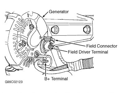

My wifes light came on and stays on. One repair dealership gave codes of P1594 & P0456 and said it needed a smog/smoke pump? Another dealership said there is not any smog pump on this van. Who is right, we have not done any repairs yet.
Saturday, November 8th, 2008 AT 5:13 AM
BMRFIXIT
  • 19,053 POSTS
P1594 CHARGING SYSTEM LOW VOLTS
check alternator , battery and charging system
https://www.2carpros.com/forum/automotive_pictures/99387_Graphic1_42.jpg
p0456 leak in the EVAP system
possible gas cap (you need a smoke machine to check for leak)its a tool that tech use to check and locate leaks in the evap system
(( I think it is a misunderstanding about the smoke pump ))
