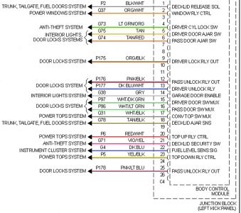

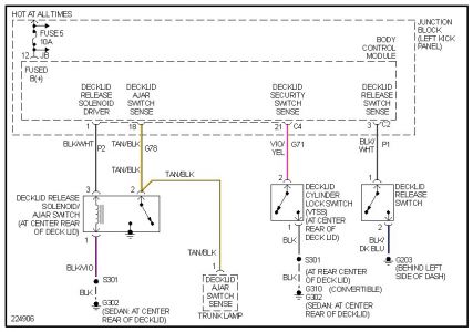

Gentlemen: when it rains fairly steady and the car is parked outside for a couple of hrs, you get in and the car will not start and the dash display says DECK, which means the declid is open. When you go to the trunk, it is not open and you have to use the key to open it since there is no power. Have to jump start it and then the light goes out. This has happened 3 times. Any quesses? Please

I haven't found anything that is of value. What I would recommend is when the problem happens and it isn't starting, call the dealership and have them pick it up.
Prior to this, speak with the service manager and explain how this needs to be taken care of and since they are unable to reproduce it in the dealership, they need to address it in a timely fashion when it happens. He should understand the situation as it is a intermittant problem.
The problem may have nothing to do with the DECK and that is probably another symptom as opposed to a causal area.
I would be suspicious of the body control module connector area:
https://www.2carpros.com/forum/automotive_pictures/30961_deck_1.jpg
The deck lid ties into it.
You can see that the Anti-theft is also on this connector and may be the source of the no-start:
https://www.2carpros.com/forum/automotive_pictures/30961_deck1_1.jpg
If I come across anything, I'll update you. This problem should be treated as an intermittant no start. By finding what component is missing from the combustion it can be back traced to the source...hopefully in a painless way.
