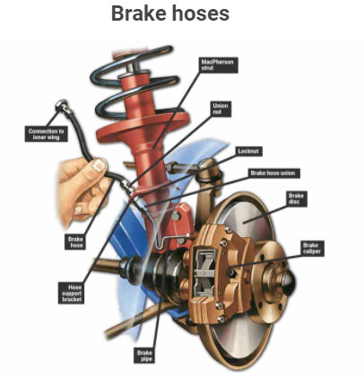

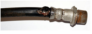

We had 4 new rotors installed. Now they tell me I need new front brake hoses.
Saturday, May 31st, 2008 AT 10:12 AM
BORIS K
  • 765 POSTS
The rubber brake hoses at the wheel tend to wear out over time. They perish, become frayed or soft. They would then need to be replaced, preferably in axle sets. I have attached 2 YouTube videos on how to replace those brake hoses.
Please see attached illustrations regarding front brake hose location and wear pattern.
