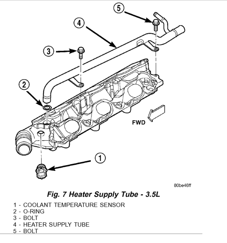

changed the water pump and timing belt thinking the water pump was what was leaking. After changing still have the leak. Only leaks while sitting overnight. Does not leak while running. Leaking through a big cast opening hole which looks like it was designed to tell you what was leaking. 3.5liter
don't know what to check now.

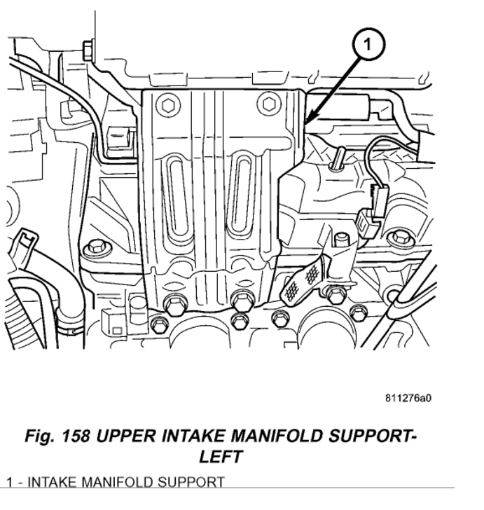

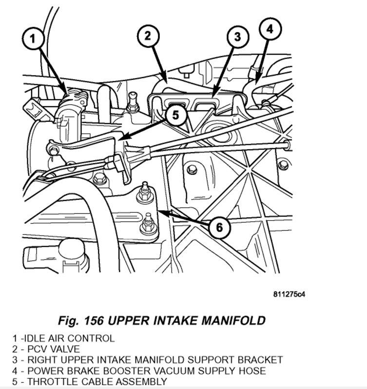

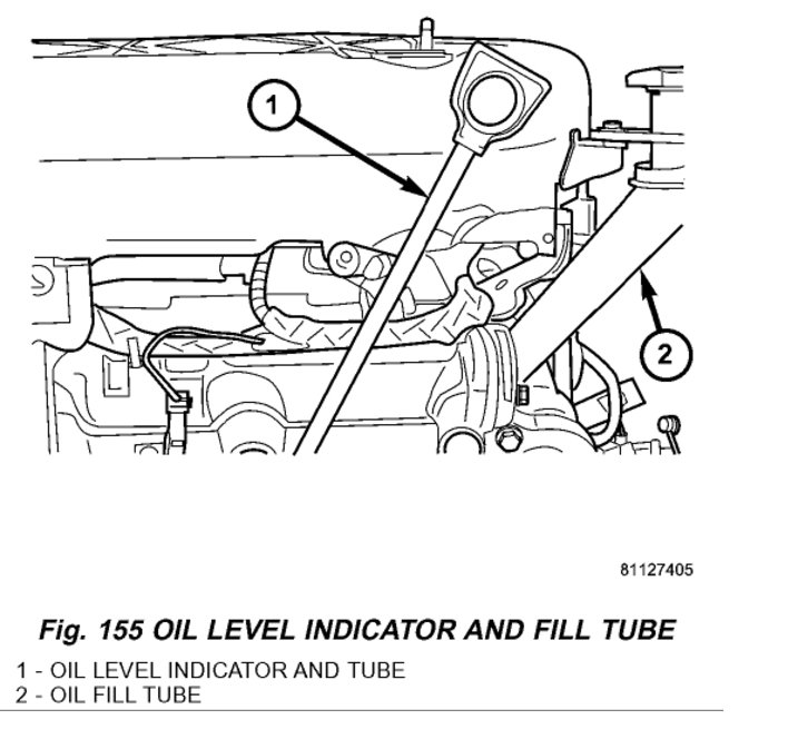

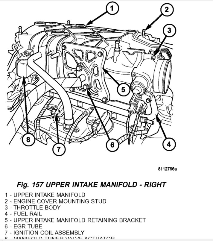

There is a coolant pipe that runs under the intake manifold which is seals by an O ring. The intake must be removed to replace the seal. Here is a guide that will give you an idea on what you are in for and some diagrams to help you get the job done.
https://www.2carpros.com/articles/replace-intake-manifold-gasket
and
https://www.2carpros.com/articles/car-is-leaking-coolant
Please let us know what happens so it will help others.
