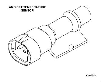

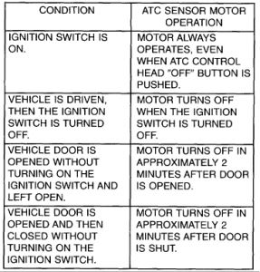

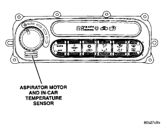

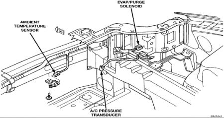

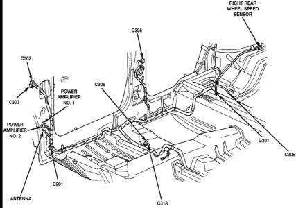

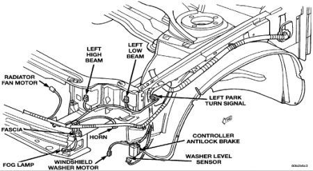

Hello - just a couple of things you might check/try. First read the info on ATC In-Car Temperature Sensor and Ambient Air Temperature Sensor. Me I would first do the check on the sensor motor fan, I have attached that. I don't believe it is the thermistor in the ATC only because it says it should be throwing a code. You said the dealer/shops don't see a code. I would next, go ahead and replace the Ambient Air Temperature Sensor (I have attached the pics where it is) mainly because if the sensor motor fan inside the car is working after the test, the thermistor appears to be working (no codes) the Ambient Air Temperature Sensor "...is used by the ATC system to adjust blower speed, temperature offsets, evaporator temperatures and mode control." This seems more like what you are saying. Plus it is only about $17.00 by my info at the dealer, part number 4688204. You might check Auto Zone, O'Reilly's etc also. Good luck and be safe. ATC In-Car Temperature Sensor The Automatic Temperature Control (ATC In-Car Temperature Sensor returns electrical signals to the Body Control Module (BCM). The In-Car Temperature Sensor is used on ATC equipped vehicles only. The In-Car Temperature Sensor is made up of two parts. One part is the in-car sensor motor fan assembly and the second part is a temperature thermistor. The in-car sensor motor fan assembly attaches to the back of the ATC Control head. This assembly has a small fan and a motor which draws air through the intake on the front of the ATC control. The in-car sensor thermistor is located inside of the ATC Control Head. Air drawn from the passenger compartment by the in-car sensor motor-fan assembly, flows over the thermistor. The in-car sensor thermistor changes resistance with air temperature. The BCM measures this resistance and calculates the temperature of the air drawn into the ATC Control. The ATC system then makes adjustments to maintain the optimum passenger compartment comfort. Refer to the ATC Sensor Motor-Fan Operation table for when the ATC Sensor is operating. The in-car sensor motor is a separate serviceable part connected to the ATC Control Head. See Diagnosis and Testing for proper check of airflow. The in-Car Sensor Thermistor is part of the ATC Control Head and not a separate serviceable part. One must replace the ATC Control if the ATC self-diagnostics indicates a fault code. Ambient Air Temperature Sensor The ambient air temperature sensor is located on the inside of the right front bumper beam. This sensor will inform the ATC system of the ambient temperature outside the vehicle. This sensor is used by the ATC system to adjust blower speed, temperature offsets. evaporator temperatures and mode control. The ambient sensor is not serviceable and must be replaced if found to be defective. The ambient temperature sensor is used on all LH vehicles with or without ATC systems. In-car sensor motor fan test 1. Perform air flow test to check motor/fan assembly. a. Turn ignition to the ON position and push the OFF button to stop the ATC system airflow. This will make it easier to observe paper in the step Step b. Place a small piece of newspaper in front of the sensor/motor opening on the ATC control. If the paper sticks to the opening, the In-Car sensor/motor is operating properly. The piece of paper should be only large enough to cover the grille opening. 2. Check if the electrical connection and connector are OK. 3. Check for the two foam seals and their condition, it is absolutely necessary for proper sensor operation. a. Seal on the inside surface directly behind the nameplate. b. Seal (strip) located directly to the right of the right center duct opening (instrument panels with trim bezels).
https://images.2carpros.com/forum/automotive_pictures/248015_Ambient_Sensor_1_1.gif
https://images.2carpros.com/forum/automotive_pictures/248015_Ambient_Sensor_2_1.gif
https://images.2carpros.com/forum/automotive_pictures/248015_ATC_Sensor_MotorFan_1_1.jpg
https://images.2carpros.com/forum/automotive_pictures/248015_ATC_Sensor_MotorFan_2_1.gif

So far, I've verified that the in car sensor motor and fan are drawing air in through the intake.
I'll take a look at the ambient temperature sensor as soon as I can crawl under the car and locate it. Is there any testing that can be done on the ambient sensor, such as resistance tests with varying temps...???

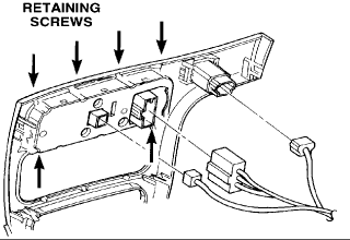

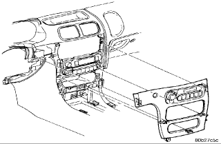

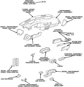

Is it possible to verify that the trim around the ATC head is only held in place with a few screws in the lower area...??? Once those are out, I'm guessing the trim should be easily removed and the ATC head can be worked on.

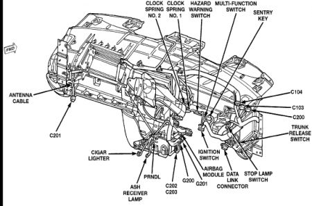

Hello Bill As for the trim, I have attached pics. It appears to be held in with clips. It always makes me nervous to pull on the plastic parts etc as it is hard to tell at times how it is held in. You might ease a flat tip screwdriver along side and gently pry. Not to small as it may chip. You might put a rag between the screwdriver and the dash to prevent any damage. Some are held in with screws once you remove the ash tray or other surrounding items. But if you look at the pic, it doesn't look like it. Then the next pic shows the back of the panel, removing the plugs. The screws hold the control unit in. You might consider calling the parts department and see if you have to order screws or clips for it. That would be a sure thing. Me, the less you remove the better. I would still just replace the sensor at the front of the car since it is inexpensive. I don't show a check for that though there may be one but if it is intermittent it may check good and then bad on the car. Again, it's the least expensive and so far your check of the ATC shows it is okay. Not sure if this helps........hope so. Good luck.
https://images.2carpros.com/forum/automotive_pictures/248015_ATC_Head_removal_1_1.gif
https://images.2carpros.com/forum/automotive_pictures/248015_ATC_Head_removal_2_1.gif

I've located and removed the ambient temp sensor. Interestingly, that had no effect on the operation of the blower speed. That could indicate the sensor is open, resistance-wise. I haven't had the time to test it to see what resistance might be there.
I've also managed to remove the trim and look at the ATC head. All appears to be okay in that department. You were right; it IS scary pulling on the plastic. Once I got it out, I can see that it's not that big a deal for future work in that area.
Tomorrow I'ill buy the ambient temp sensor and replace it. With luck that will be the culprit....

Well, I purchased an OEM ambient temp sensor and replaced it. No change in the symptoms.

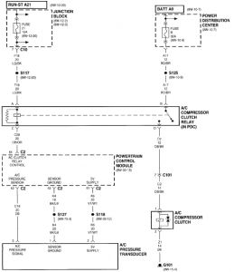

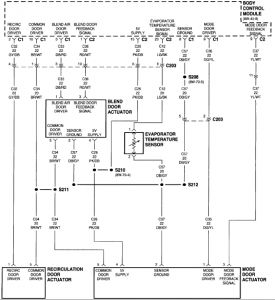

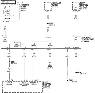

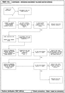

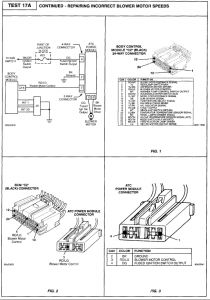

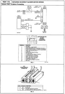

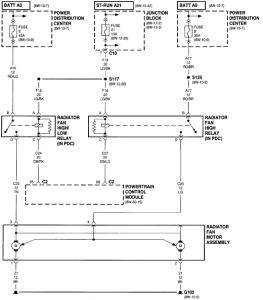

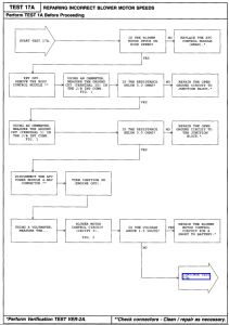

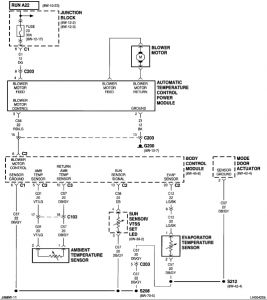

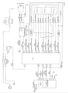

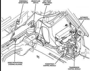

Good morning Bill - glad to see you got the shop manual....it does help. The erratic/stuck on high fan - here is a troubleshooting chart for that. Still might be that relay....I will check into that and the code 51 for you....gotta run but wanted to get this to you. I'll check more shortly. Bob
https://images.2carpros.com/forum/automotive_pictures/248015_Fan_Speed_1_1.jpg
https://images.2carpros.com/forum/automotive_pictures/248015_Fan_Speed_2_1.jpg
https://images.2carpros.com/forum/automotive_pictures/248015_Fan_Speed_3_1.jpg
https://images.2carpros.com/forum/automotive_pictures/248015_Fan_Speed_4_1.jpg
https://images.2carpros.com/forum/automotive_pictures/248015_Fan_Speed_5_1.jpg
https://images.2carpros.com/forum/automotive_pictures/248015_Fan_Speed_6_1.jpg
Blend Door Actuator Body Control Module Evaporator Temperature Sensor Mode Door Actuator Recirculation Door Actuator
https://images.2carpros.com/forum/automotive_pictures/248015_Fan_Speed_7_1.jpg
Automatic Temperature Control Body Control Module Fuse 17 (JB) G201 Headlamp Switch Junction Block
https://images.2carpros.com/forum/automotive_pictures/248015_Fan_Speed_8_1.jpg
Ambient Temperature Sensor Automatic Temperature Control Power Module Blower Motor Body Control Module Evaporator Temperature Sensor Fuse 23 (JB) Junction Block Mode Door Actuator Sun Sensor/VTSS Set Led
https://images.2carpros.com/forum/automotive_pictures/248015_Fan_Speed_9_1.jpg
A/C Compressor Clutch A/C Compressor Clutch Relay A/C Pressure Transducer Fuse 21 (JB) Fuse B (PDC) G101 Junction Block Power Distribution Center Powertrain Control Module
https://images.2carpros.com/forum/automotive_pictures/248015_Fan_Speed_10_1.jpg
Fuse 21 (JB) Fuse B (PDC) Fuse E (PDC) G105 Junction Block Power Distribution Center Powertrain Control Module Radiator Fan High Relay Radiator Fan High/Low Relay Radiator Fan Motor Assembly

I started going over the info, I just don't see this Blower Motor Relay.......can you send me what you have.
SYSTEM OPERATION
The blower motor power module is only used in vehicles equipped with Automatic Temperature Control (ATC) . it is located on the lower right side of the HVAC unit housing.
The power module receives pulse width modulated signals from the Body Control Module. The power module varies voltage to the blower motor for different blower speeds based on the ATC software. There are 14 speeds and a blower off signal.
I see the code 51 in the charts but it doesn't give any info about fix........still checking but wanted to get this to you.

I'm sorry for the red herring about the "blower motor relay". It is properly called the blower motor power module. The "relay" came from some other on-line resources that referred to it as a "solid state relay" which is probably a technically correct description but not what is commonly used in the manuals.
I have found more codes.... I didn't figure out how to page from the first code to the rest until I sat in the car again and tried to figure out what they meant by "panel switch". "Panel" here refers to the A/C outlets in-dash......
The full complement of codes is now: 51 [System voltage too low for door calibration], 26 [ATC thermistor failure], and 35 [Evaporator sensor failure].
I don't know what the 51 is all about; I think it'll be on the back burner. Regarding the ATC thermistor, I'm leaning toward replacement of the ATC head on that one. And, regarding 35, again, it'll be back burner.
With the info you've provided I've got some more testing to do. I think it would be wise to erase the DTC codes via removal of the M-1 fuse and start with a clean slate to see what's real and what's not.

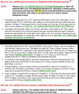

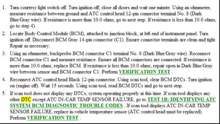

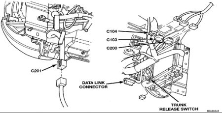

Bill - Okay, some more checks based off the codes. Code 26 NAME OF CODE In-Car Temperature Sensor Failure WHEN MONITORED With ignition on SET CONDITION BCM senses an abnormally high or low voltage in the in-car temperature input THEORY OF OPERATION The in-car temperature sensor is a thermistor for which the BCM provides a 5V pull-up. Under normal operating conditions (-40 to 85 °C) this voltage should be between 0.313V and 4.88V PROBABLE CAUSES "¢ Wiring open circuit "¢ Wiring short to ground "¢ Wiring short to battery "¢ Failed sensor "¢ Failed BCM
https://images.2carpros.com/forum/automotive_pictures/248015_Code_26_a_1.jpg
https://images.2carpros.com/forum/automotive_pictures/248015_Code_26_1.jpg

Hi Bob....
Thanks again for your response. I'm guessing from the time-stamp on your response that: (1) You are recieving a really good salary to do this work and thereby motivated by the pay, or (2) you really do enjoy this kind of challenge and get a lot of satisfaction from seeing a job finished. Hmmm.... I'll put my money on # 2...!!
Where I'm back into the "work week" mode, I'll have a little less spare time to peck away at this beast. With the latest input and the previous post, I have some really good specific issues to check and can make the most of my time. My money would be on a defective in-car temp sensor just based on intuition and what is available from the symptoms.
As soon as I can run these latest tests, I'll let you know. I'm really hoping to find the ATC thermistor is defective because I really don't want to tackle tearing apart the dash to gain access to the BCM.
As soon as I have more to post, I'll do it.

You can go with number 2. It does seem to be leaning to the thermistor……Before there were not codes, now there are which if I remember correctly that is what the troubleshooting chart pointed to replacing if there were codes.

I keep coming back to the primary symptom of the blower speed being stuck at high. This takes me to the "TEST 17A: INCORRECT BLOWER MOTOR SPEEDS". Reading through this area, it appears the most likely culprit is the blower motor power module. The only way to be 100% certain though is to go through the entire set of tests that are listed in 17A. I'm really tempted to just buy a used power module and replace it rather than tear apart the dash to get the BCM out for testing. I know that's not the professional approach to this issue, but time-wise, it seems like it might be the easier route. Not having taken the BCM out yet, I'm just guessing that it is a chore. I might be wrong.
Another problem I have is that I bought an inexpensive DRB II code reader and everything I read in the manual indicates that the only way to really get the detailed info is to use a "scan tool" to test the many individual parts of the system.
It still seems like multiple problems, most likely being the blower motor power module, with the background issue being the ATC head.
Out of time tonight.....

Well my friend, ……….you sound tired…..frustrated……..understand. I would be too. Based off what you said, cleared codes, ran test, no codes. Did you drive the car and then run the test? I would do that. Also, electrical stuff……..wow, you can chase gremlins forever. Now it’s bad, 2 minutes later it’s good. I would rather the part just explode than go back and forth.
For the Test 17A, since you are just testing connectors, I wonder if you can do this without removing the BCM? I would check that. Also, maybe run through the tests – eventually the last thing is replace the ATC.
Professional approach…..don’t be too ruff on yourself……sometimes that is the professional approach. Let’s review: If I remember correctly you stated, “I've had the car to the dealer twice, a general automotive repair shop once, and to two A/C shops. Each time, they say that they can't find anything wrong with the system, meaning that the system is not setting any fault codes.” Sounds like the professionals with all of the tools were having a hard time too. It is giving us all a hard time. Then also as you said needing a scan tool. To me Bill you have done a fantastic job keeping your sanity and doing all the checks you have at home. It is a lot harder for you since you don’t have all the tools, equipment, time, etc. One of the rules is, the less you take apart the better. Before long you have the entire car torn apart and the problem didn’t need it. I would have to agree…..sometimes changing the easiest part and working your way when you don’t have all of the resources is the best for time-money etc.
Maybe clear all codes unhook the battery and let it sit. Hook the battery back up and take it for a drive for some ice cream. From what I understand a large of anything like this helps cool the brain to think better. During the drive, run through the system, auto, manual, keep track of what is going on when. We may have missed something simple. Do all things with the AC first. Then all things with the heater. Then once home, check the codes. Let’s see what that does.

Re the 17A tests.... to do the voltage and continuity checks, you have to remove the BCM from it's mount to verify several of the readings. If there was a way to do it without, I'd vote for that. But, I don't see that in the manual.

Tore into the car. I followed the troubleshooting procedures as best as I could.
Here are some observations:
1 - Starting at 17A for the incorrect blower motor speed, it tells you to remove the BCM. However, the only way you'll ever find out how to do this is to stumble into the Technical Service Bulletin regarding the erratic operation of the ATC. In the bulletin, they have very clear instructions for removal of the BCM. If I've missed these instructions somewhere in the manual, I like my crow well done, thank you.....
2 - These instructions are simple enough and should be part of the repair manual. Each step along the way of troubleshooting in 17A, except # 2, has you run the verification test. This requires reassembly and reinstallation of the removed parts and then running a complete retest of the whole system. For 17A, this would result in several removal and installation cycles. From past experience, the more you do something like this, the more likely it is you'll bugger something up.
3 - Where the wiring is the least likely problem and the blower motor power module is most likely to be the problem, when the blower only operates in high, it is a waste of time and a hassle to mess with the BCM at the beginning of the process. The final steps in 17A , where you connect a jumper to the red/light green wire of the blower motor power module 4-pin connector cuts to the heart of the matter. If the connector is shorted to ground and the blower still runs in the high speed mode, IT'S TH E BLOWER MOTOR POWER MODULE...!!! If that test doesn't give the results you need, then work back toward the BCM.
When all was said and done, my fear of the BCM removal was based on ignorance of the actual process. If I had not stumbled into the Tech Service Bulletin, I'd probably still be standing in the driveway saying, " I don't really want to do this.... ............ "

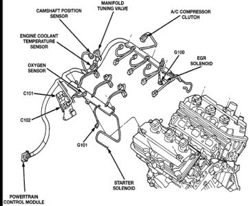

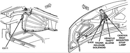

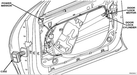

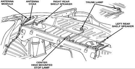

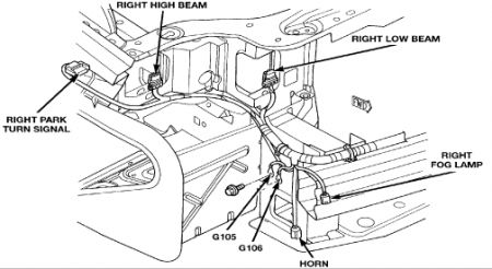

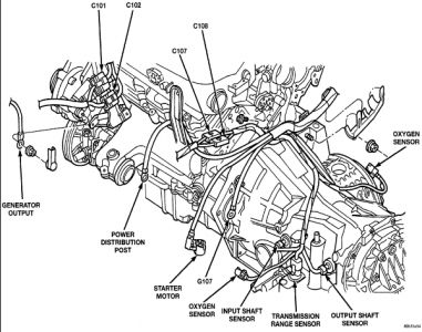

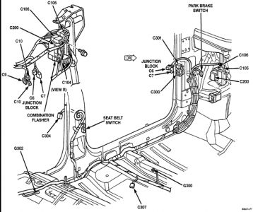

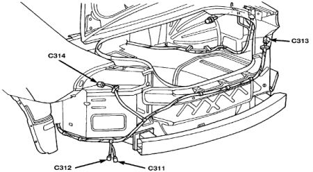

Hello - Bill Sorry about the ATC but sure glad to hear from you. Hope your trip went well.....really sorry about the ATC. Well, that's a downer but let's take another shot before the BCM. Based off what you said I have attached all the info figures on grounding points. Hope that helps. Next, the sensor's I show is the ambient temp sensor; you replaced that on the front and the Cabin one that is on the ATC. There is a solar sensor, looks like about $40. The only check I could find is for the plug. I will give you what I got on that. What about taking a wire and grounding the ATC directly, to a good surface inside the car? For the trunk release....the last pick is the connector. Are you sure the button just isn't working? I would jump the connector at the button to see if it works at the trunk. Also, this should be the connector at the trunk. Have someone press the button and check for voltage at the plug. Another idea. Clear the codes. Go for a drive, I suggest ice cream again. When you get home review the ops checks you have accomplished from the start and run through those and maybe it will show us something different. Okay, I am sure you are tire after the trip. After a good night sleep, time with the family and a god cup of coffee in the morning maybe this won't looks so bad. Let me know if I can help.
https://images.2carpros.com/forum/automotive_pictures/248015_f1_1.jpg
https://images.2carpros.com/forum/automotive_pictures/248015_f2_1.jpg
https://images.2carpros.com/forum/automotive_pictures/248015_f3_1.jpg
https://images.2carpros.com/forum/automotive_pictures/248015_f4_1.jpg
https://images.2carpros.com/forum/automotive_pictures/248015_f6_1.jpg
https://images.2carpros.com/forum/automotive_pictures/248015_f7_1.jpg
https://images.2carpros.com/forum/automotive_pictures/248015_f8_1.jpg
https://images.2carpros.com/forum/automotive_pictures/248015_f9_1.jpg
https://images.2carpros.com/forum/automotive_pictures/248015_f10_1.jpg
https://images.2carpros.com/forum/automotive_pictures/248015_f11_1.jpg
https://images.2carpros.com/forum/automotive_pictures/248015_f12_1.jpg
https://images.2carpros.com/forum/automotive_pictures/248015_f13_1.jpg
https://images.2carpros.com/forum/automotive_pictures/248015_f14_1.jpg
https://images.2carpros.com/forum/automotive_pictures/248015_f15_1.jpg
SYSTEM OPERATION The sun sensor is only used on vehicles equipped with Automatic Temperature Control (ATC) . The sensor is mounted on the top of the instrument panel below the instrument panel top cover. This is not a thermistor type sensor but rather a photo diode. For this reason the sun sensor responds to sun light intensity rather than temperature. It is used to aid in determining proper mode door position, temperature door position and blower speed. The sun sensor is also used to sense day/night conditions for automatic headlight control if so equipped, and has an LED indicator for the vehicle security system. The sun sensor is not serviceable and must be replaced if found to be defective. The sun sensor is located so the sun hits the sensor in the same way that it hits the driver and the passenger. It is important that the area in front of the sensor be unobstructed. Check that the following items are not in the way of the sun sensor. Windshield wipers that are adjusted too high. Stickers on the windshield that are directly in front of the sensor. Top cover which is not properly installed. The sun sensor should be 1/4 inch . above the top cover. Caps or papers which might cover the sensor. Removal of Solar Sensor Open hood and disconnect the negative battery cable remote terminal from the remote battery post.
https://images.2carpros.com/forum/automotive_pictures/248015_Solor_1_1.jpg
Remove the instrument top cover. Remove tile two sun sensor mounting screws.
https://images.2carpros.com/forum/automotive_pictures/248015_Solor_2_1.gif
Disconnect the wire connector and remove the sensor. INSTALLATION For installation, reverse the above procedures
https://images.2carpros.com/forum/automotive_pictures/248015_Solor_3_1.gif
Trunk connector
https://images.2carpros.com/forum/automotive_pictures/248015_Trunk_1.gif

Instead, I decided to take a look at one of the peripheral issues - the trunk release button inop. I tracked down the issue in the maintenance manual and printed out the troubleshooting procedure. The trunk releases just fine with the remote on the keychain but not from the release button in the dash. I've shorted the pins of the trunk release button connector to simulate the button being depressed with no results. I've measured the resistance across the button contacts and the button appears to be working fine. I went through procedure 12A for the Power Door Lock Test - Inoperative Decklid Release. The wiring continuity is fine from the button to the BCM and, obviously, from the BCM to the truck release itself. I didn't remove the BCM and short between pins 7 & 8 of the BCM 20 pin connector because I know the BCM is using that circuit to release the decklid when I use the remote on the key. That only leaves the BCM from what I see. Now, trust me, I wouldn't replace the BCM just because the trunk release button isn't working. I just see this as further confirmation of my suspicion that the BCM is not working correctly.
I just can't shake the feeling that the BCM is the root cause of all of these issues: ATC head not working correctly; interior lights going on and off by themselves concurrent with dimming/brightening of the dash/panel instruments and indicators; and trunk release not working. I'd love to be able to just plug in a new BCM just to see if it fixes these problems. Realistically, I know I can't afford that much just on a whim. On the other hand, I probably can justify one from a salvage yard, but that would be a pig-in-a-poke itself.
