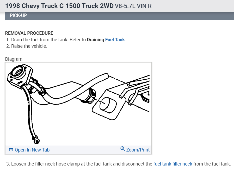

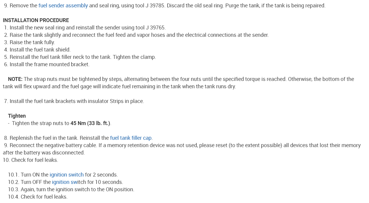

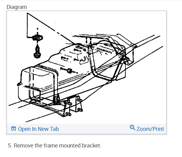

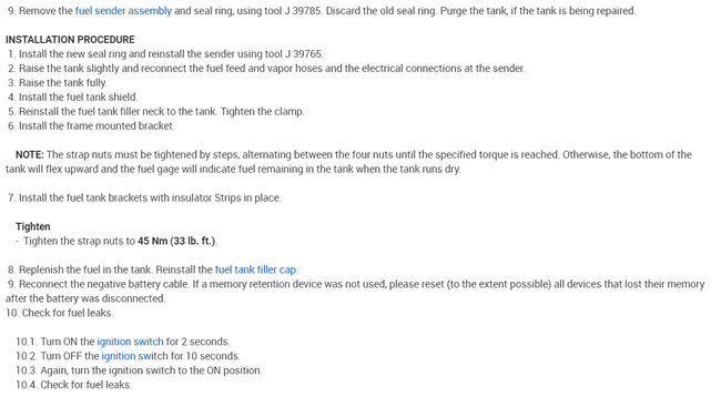

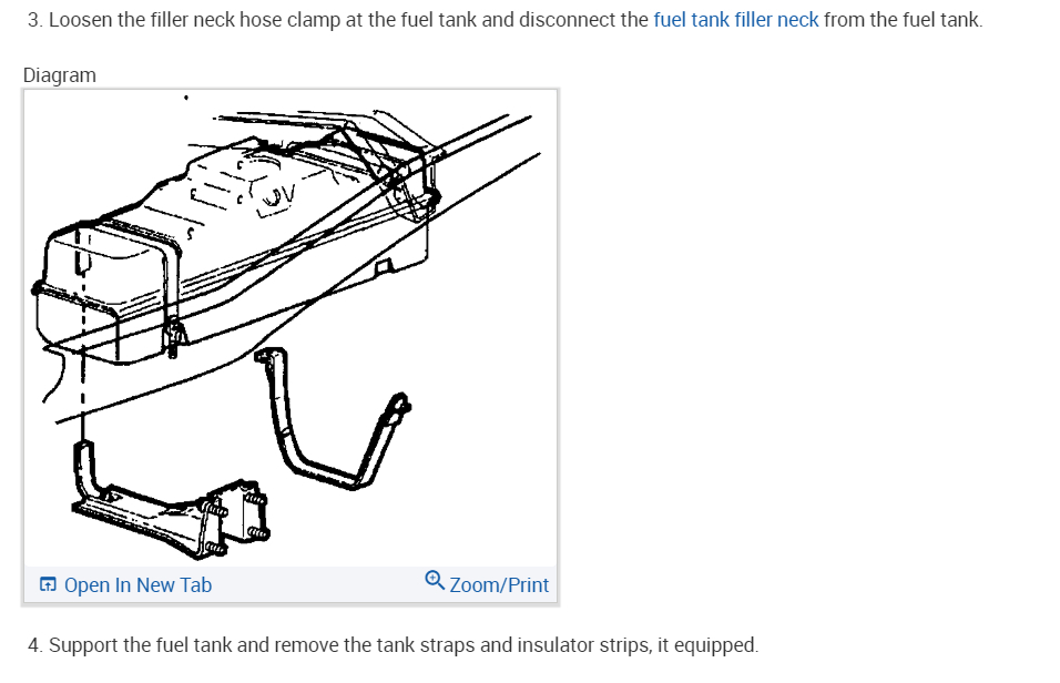

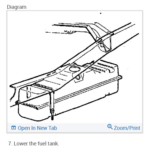

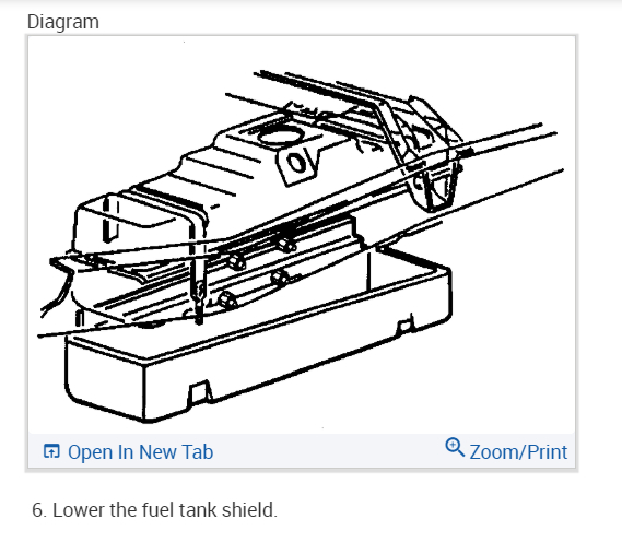

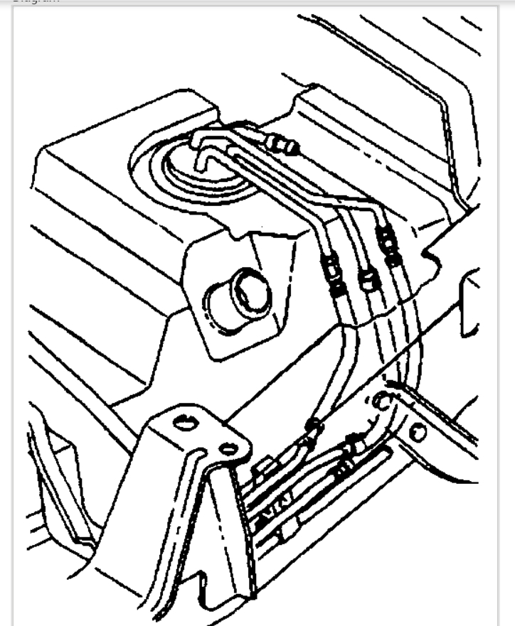

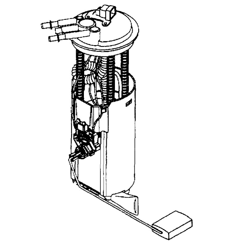

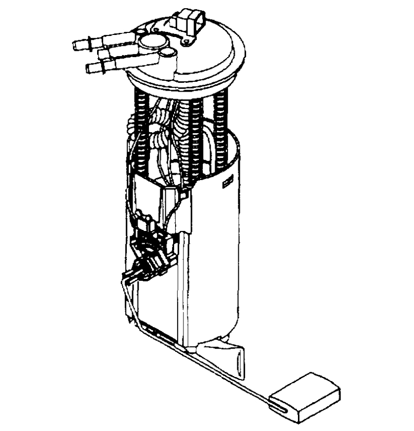

This is common when the fuel pump goes out, I had this truck and had to out 2 fuel pumps in it. Here is how to fix the problem. Check out the images (below). Please let us know what happens.
