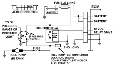

Hi there mookmikey and TY for the donation this is what keeps the site going. Check the fuel pressure if its within specs if okay test the fuel pump relay and the fuel pump/oil pressure sending unit-

i checked relay it was good and has good fuel pressure i was thinking the oil pressure switch but inside my truck shows good oil pressure could that still be the issue

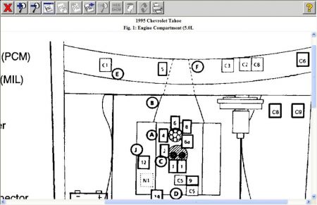

Won't hurt to check it-Or do this find the fuel pump test connector and power it this will constantly operate the fuel pump
BTW what was the fuel pressure reading?
The fuel system primes up for 2secs then the fuel pump relay deenergized while the engine is being crank over oil pressure above 4lbs will close the Fp/Oil pressure switch and then it powers the fuel pump

i dont remeber the fuel pressure but had someone come out to check it and they said it was good and that diagram you sent is that the pre obd2 connector in the truck it looks the same and is that were i can test the fuel pump
Jun 25, 2020 at 7:21 PM (Merged)
  • CAR REPAIR CONTRIBUTOR
  • 75,992 POSTS
The fuel pump test connector is located on left rear of engine compartment see C8 for location
https://images.2carpros.com/forum/automotive_pictures/12900_fp_test_connector_1.jpg
