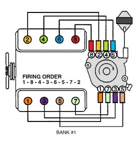

Firing order ?
http://www.2carpros.com/forum/automotive_pictures/99387_57_chevy_1.jpg
Thursday, March 20th, 2008 AT 7:08 PM
JAYPEE
  • 17 POSTS
Firing order, what do you mean by that.
Thursday, March 20th, 2008 AT 7:11 PM
BMRFIXIT
  • 19,053 POSTS
I sent the picture with it for the firing order
i noticed also you send that you have spark @ 1 and 8
what about the rest do u have spark
on all

I had included the firing order may be you want to check that
also we had problem with coils and distributor cap we replace them all the time on that engine
may be you should check that too

Check the coil and the firing order
Friday, March 21st, 2008 AT 6:09 PM
JAYPEE
  • 17 POSTS
I replaced the coil and I had two wires in wrong. The number 2 and 4 wasn't in the correct firin order and I found out the number 8 wasn't all the way on. I had it towed to a shop today and the dude told me it was the feul pump went out. After I sprayed the starter fluid in it. It never started, so could the fuel pump be out or is he tryin to pull as fast on on me
