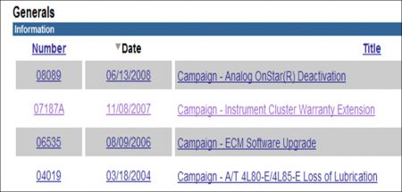

Hello
I attached the entire recall on the speedometer and as you see, it also says the fuel gauge, just as your letter says. It is possible but at 68000 miles I find it hard to believe the sending unit is bad..especially in light of this recall.

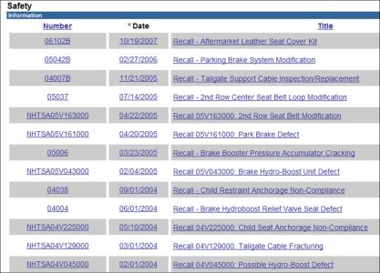

You also have several other recalls.general in nature and numerous safety recalls. I would definitely check them all with the dealer to verify your vehicle is not affected by them or it is and have them fixed.
Next - as you see by the brief info on the fuel sender unit, they have to remove the fuel tank. If it were me, I would mark several items in a way that only you know to verify at a glance that they definitely removed the fuel tank. Also, sometimes it is easier on some models to disconnect the bed and slide it back. So, I would make some bolts or something like that to prove that the bed was moved back.
This way if they say they had to replace the sending unit, you ask them how they did that. If they said we dropped the tank. I would crawl under it and look at the items I had marked to see if the marks moved etc to verify. If they didn't I would ask them about it.
You might also consider telling them you want to be there to watch them plug the new cluster in and see for yourself. They may scream you can not be in the work area due to insurance but you can still ask.
Let me know how it goes. . ...and please mark things. . .. . ..

The recall we are talking about
Campaign - Instrument Cluster Warranty Extension
Bulletin No.: 07187A
Date: November 08, 2007
SPECIAL COVERAGE
Subject:
07187A - SPECIAL COVERAGE ADJUSTMENT - INSTRUMENT PANEL CLUSTER GAUGE NEEDLE FUNCTION
Models:
2003-2004 CADILLAC ESCALADE, ESCALADE ESV, ESCALADE EXT
2003-2004 CHEVROLET AVALANCHE, SILVERADO, SUBURBAN, TAHOE
2003-2004 GMC SIERRA, YUKON, YUKON XL
Supercede:
THE SERVICE PROCEDURE IN THIS BULLETIN HAS BEEN REVISED. IN A SMALL NUMBER OF VEHICLES, THE GAUGE SWEEP TEST MAY NOT ALWAYS CONFIRM THE CONDITION. PLEASE REVIEW THE SERVICE PROCEDURE IMMEDIATELY.
DUE TO PART AVAILABILITY, THIS SPECIAL COVERAGE IS BEING ADMINISTERED IN PHASES. YOU WILL BE NOTIFIED AS EACH ADDITIONAL PHASE IS RELEASED.
CUSTOMERS ARE BEING INSTRUCTED TO CONTACT THE DEALERSHIP TO ARRANGE AN APPOINTMENT IF THEY BELIEVE THEIR VEHICLE HAS THIS CONDITION. THE CUSTOMER IS BEING ASKED TO PROVIDE THE VIN SO THE IPC CAN BE ORDERED IN ADVANCE OF THE SCHEDULED APPOINTMENT. THIS WILL ELIMINATE THE NEED TO KEEP THE VEHICLE OVERNIGHT. DEALERS ARE TO OBTAIN THE VEHICLE MILEAGE WHEN SCHEDULING A SERVICE APPOINTMENT. THE VEHICLE MILEAGE WILL BE REQUIRED WHEN PLACING AN ORDER FOR THE IPC.
Condition
Some customers of 2003-2004 model year Cadillac Escalade, Escalade ESV, and Escalade EXT; Chevrolet Avalanche, Silverado, Suburban, and Tahoe; and GMC Sierra, Yukon, and Yukon XL vehicles have reported that one or more of the instrument panel (IP) cluster gauges stick, flutter, or become inoperative. This may cause inaccurate readings, including the speedometer and fuel gauge.
Special Coverage Adjustment
This special coverage covers the condition described above for a period of 7 years or 70,000 miles (110,000 km), whichever occurs first, from the date the vehicle was originally placed in service, regardless of ownership.
Dealers are to replace the instrument panel cluster after the condition has been verified. The repairs will be made at no charge to the customer.
For vehicles covered by Vehicle Service Contracts, all eligible claims with repair orders on or after September 28, 2007 are covered by this special coverage and must be submitted using the labor operation codes provided with this bulletin. Claims with repair orders prior to September 28, 2007, must be submitted to the Service Contract provider.
Involved are certain 2003-2004 model year Cadillac Escalade, Escalade ESV, and Escalade EXT; Chevrolet Avalanche, Silverado, Suburban, and Tahoe; and GMC Sierra, Yukon, and Yukon XL vehicles built within the VIN breakpoints shown.

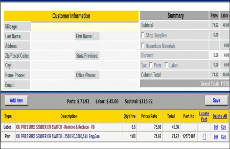

I show a part number of 25315800 for the entire pump... Should be the sending/sock and all. From the dealer it will be about $410.17. It is only about $270.34. If you go this direction I would verify with the Chevy parts department that this part comes with everything. Then get it through the GM parts.
Well on the oil gauge... This is a new problem... Yes? It looks like there is a TSB on this. It may be the oil pressure sensor, even the wiring. I have attached that for your review.
My suggestion here since there is a TSB...I would replace the sensor first..... Not the wiring as it may not be the wiring. See what it does....... Then the wiring... Then last resort drop the pan.
For that matter check both parts out on the GM site...I show it about $72 at the dealer and about $45 there... Part number 12573107.

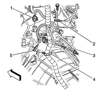

This is what I show. . .. . ...hope this helps. . .. . .. . .good luck on this and the fuel pump
Engine Oil Pressure Sensor and/or Switch Replacement
Tools Required
J 41712 Oil Pressure Switch Socket
Removal Procedure
https://www.2carpros.com/forum/automotive_pictures/248015_1_102.jpg
If necessary, remove the engine sight shield.
Disconnect the oil pressure sensor electrical connector (1).
https://www.2carpros.com/forum/automotive_pictures/248015_2_67.jpg

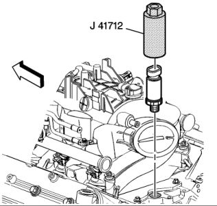

Using J 41712 or equivalent, remove the oil pressure sensor.
Installation Procedure
https://www.2carpros.com/forum/automotive_pictures/248015_3_50.jpg
Apply sealant GM P/N 12346004, (Canadian P/N 10953480), or equivalent, to the threads of the oil pressure sensor. Notice: Refer to Fastener Notice in Service Precautions.
Using J 41712 or equivalent, install the oil pressure sensor.
Tighten the oil pressure sensor to 30 Nm (22 ft. lbs.) .

Well, it sounds like the oil pressure is fixed. . .. . .. . ...I attached a rough quote. . ..you saved about $60 doing it yourself and. . .. . .. . .you gained a tool.
