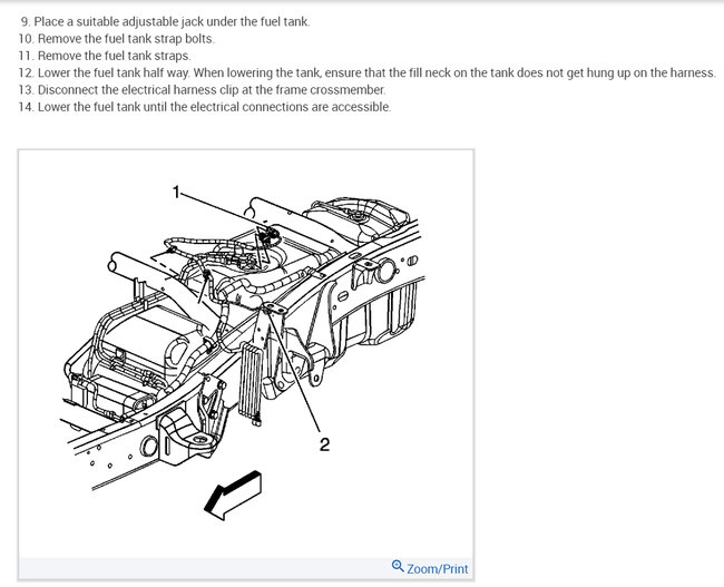

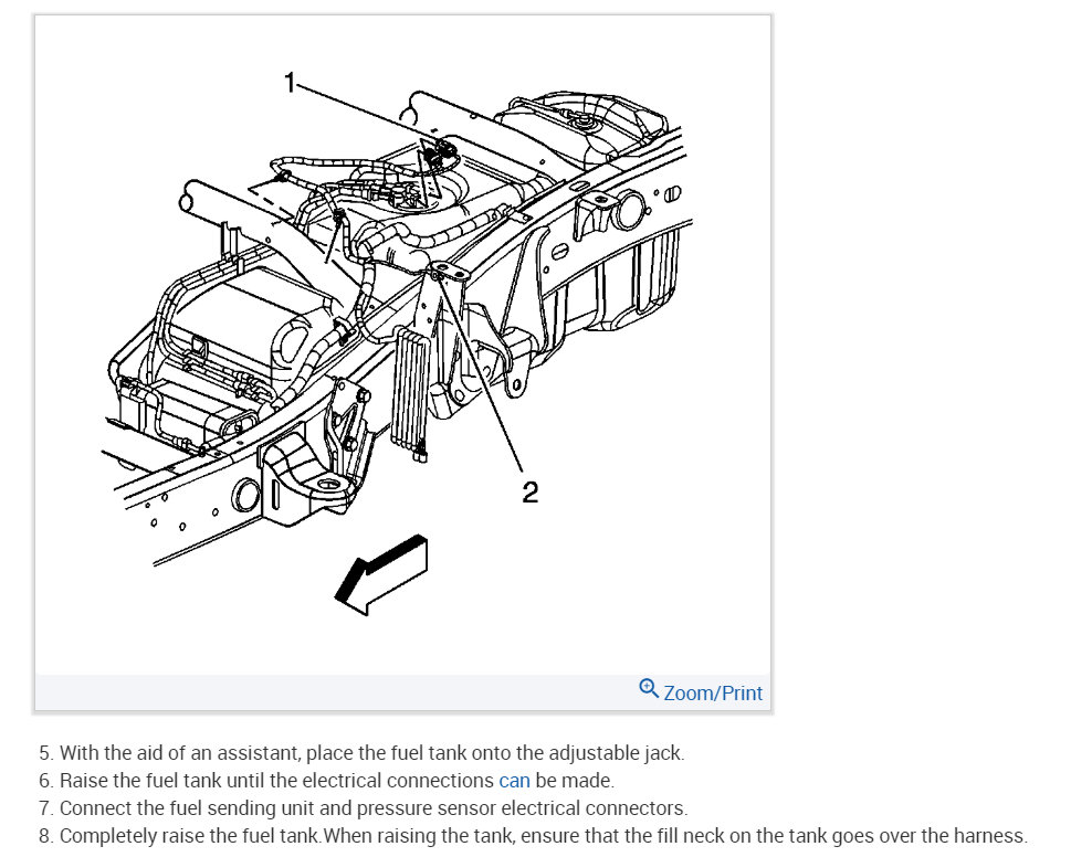

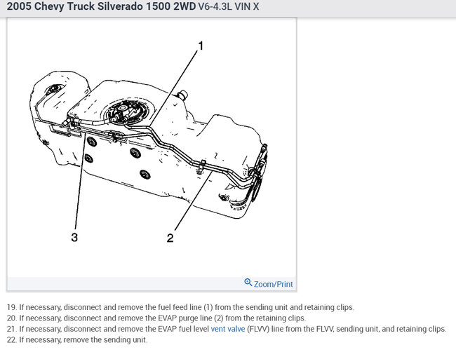

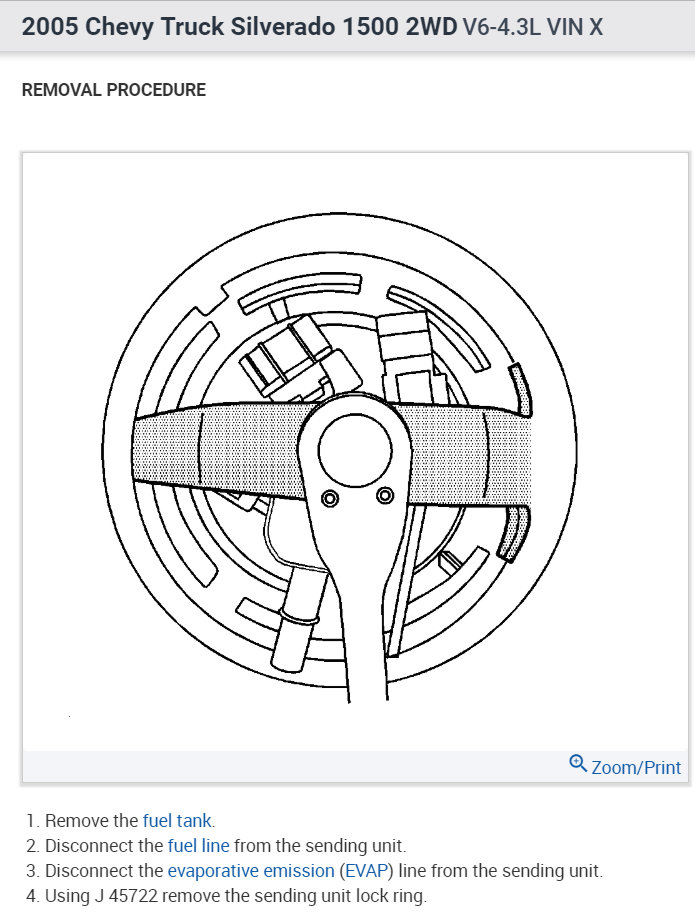

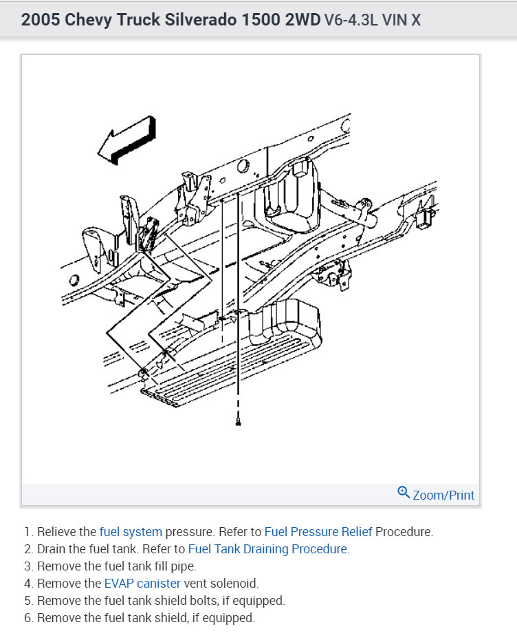

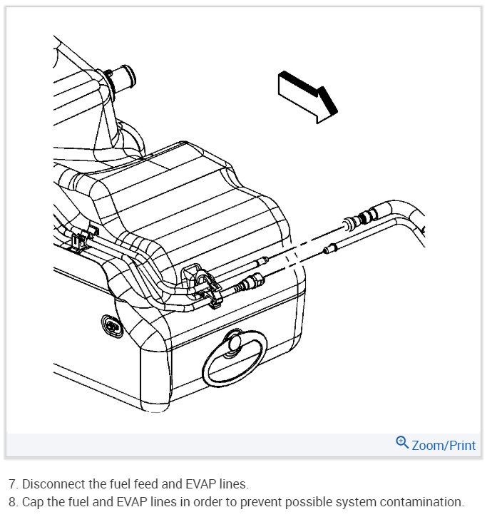

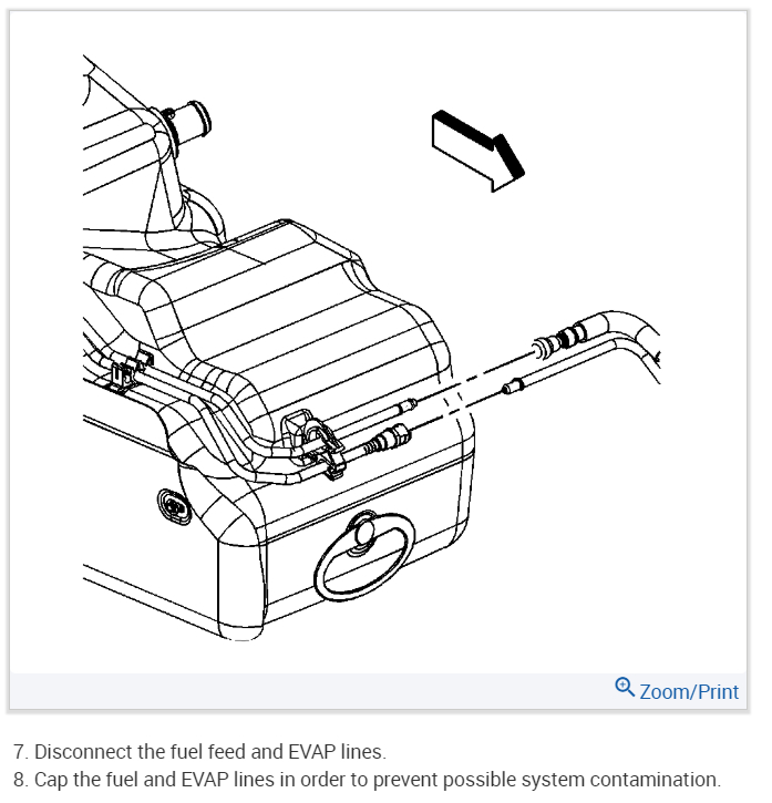

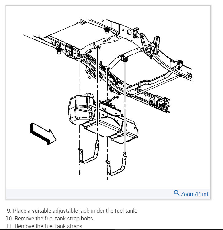

Hello, get a fuel pressure gauge and check fuel pressure for a start. Fuel pressure spec shows 58-64.
Here is how you change the pump and its location in the diagrams below. Check out the diagrams (Below). Please let us know if you need anything else to get the problem fixed.
