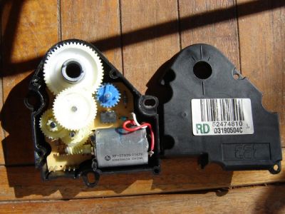

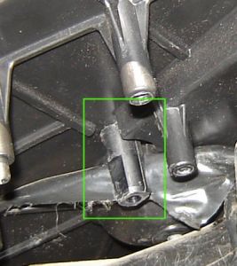

Driver side blows cold air while passenger side blows hot air when heat is on. I changed the blend door actuator for driver side still blows cold air. I even moved flap for blend door by hand to see if changing the position would make hot air come from driver side vents. But it did not. Still blows cold air I am at a loss for what it could be.
Friday, April 30th, 2021 AT 2:44 PM (Merged)
KGREENE
Okay, so I flushed core like you said from both sides small amount of debris cam out but not a lot to plug it. Still the heat only works on passenger side. I turned A/C on and only cold air came from passenger side. Is there some sensor in there that could be bad why it only blows fan air on driver side?
  • 52,797 POSTS
Nope, no sensor. You said you moved the door manually and no heat. That leaves only the heater core.

KGREENE
I changed temperature blend door all set thank you. Now I don't have to freeze!

ATJIS
  • 2003 CHEVROLET SILVERADO
  • 121,000 MILES
I have the manual temperature control with two sliders. Yesterday I noticed the system was blowing cold air even though I had the sliders all the way up to hot. When I touched the slider and adjusted them down a fraction of an inch, the system immediately started blowing hot air again. This problem continued for about a day where the system would work for a while, then stop blowing heat until I adjusted the selector down a bit, then back up. This morning the selector no longer makes any difference and my system blows only cold air.
Friday, April 30th, 2021 AT 2:45 PM (Merged)
KHLOW2008
  • 41,814 POSTS
The slider is for changing the position of the blend doors between heat and cool and it has since stopped working. You would need to check why it has stopped, which could be due to some linkages going bad or out of adjustment.
These guides will help us fix it
and

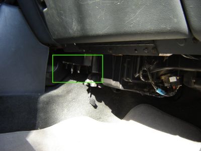

CTT
  • 2000 CHEVROLET SILVERADO
  • 173,000 MILES
I am wanting to know where the actuator that adjust where the heater air output is located.
Friday, April 30th, 2021 AT 2:47 PM (Merged)
FIXITMR
  • 9,990 POSTS
Drivers side of HVAC case under dash. Check out the diagrams (Below). Please let us know what you find.
