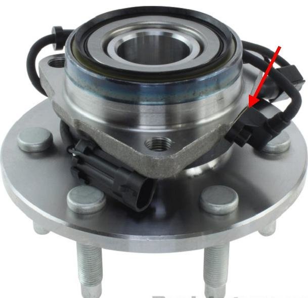

Extremely common problem on GM trucks. This is called "false activation". Due to their design, the wheel speed sensors develop rather wimpy signals, and since relative speed between the sensor's coil and the disturbed magnetic field affects signal strength, at lower speeds the signal drops too low for the computer to be able to read it. It sees that as that wheel has locked up, so it tries to modulate brake fluid pressure in a misguided attempt at getting that wheel rotating again.
Another variable in the strength of the signal is the air gap between the tip of the sensor's magnet and the rotating toothed tone ring. The problem you're experiencing is caused by rust build-up under the sensor that pushes it outward, away from the tone ring. Add in the weaker signal as wheel speed slows down, and the signal drops too low before the truck comes to a stop.
You could solve the problem by replacing both front wheel bearing assemblies, but it is faster and just as effective to remove the sensors and scrape off the rust.
The first photo shows the bearing assembly as you'd pull it out of a box. The second one is of the sensor unbolted and pulled out. The blue arrow shows where the rust develops that pushes the sensor away from the tone ring. As long as it is removed, clean off any rust or metal filings that are clinging to the magnet at the red arrow. That can also lower the strength of the signal.
If you want to do this yourself, start with this article, but it's the video at the end that pertains to this service. You'll see how to start the process of removing the wheel bearing assembly, but you don't have to go that far. Use this to see how to get down to the wheel speed sensor.

This is a real common occurrence with GM trucks. It's called "false activation", meaning the ABS is kicking in when it isn't needed. Most commonly this is caused by rust build-up under the front wheel speed sensors. These sensors develop real wimpy signals to start with, then, as the rust pushes the sensor away from the tone ring, the signal gets even weaker, to the point the computer can't see it, and it interprets that as that wheel is locking up.
When a voltage is developed mechanically, you need a coil of wire, a magnet, and most importantly, movement between them. As the movement, or speed, slows down, the strength of the voltage gets weaker. That's why this problem occurs at relatively low speeds.
Start by removing the front sensors and looking for rust under them and on the bearing housing. My nifty red arrow in the photo is pointing to where that rust builds up.

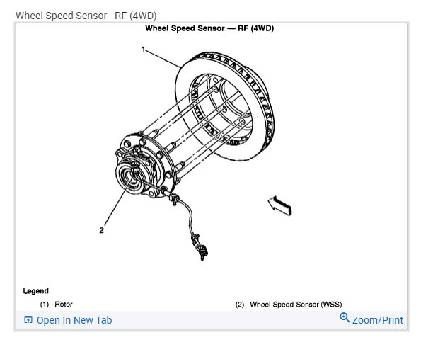

Wheel speed sesnor are the sensors at each wheel. They are a magnet and they detect how fast the wheels are turning by measuring the gaps in a moving tone ring. That tells the computer how fast each wheel is turning and if one is locking up. They are easy to find. Look for the wires goign to each wheel what the attach to is the sensor
