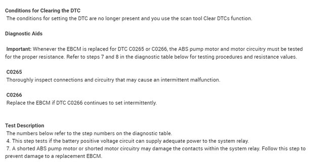

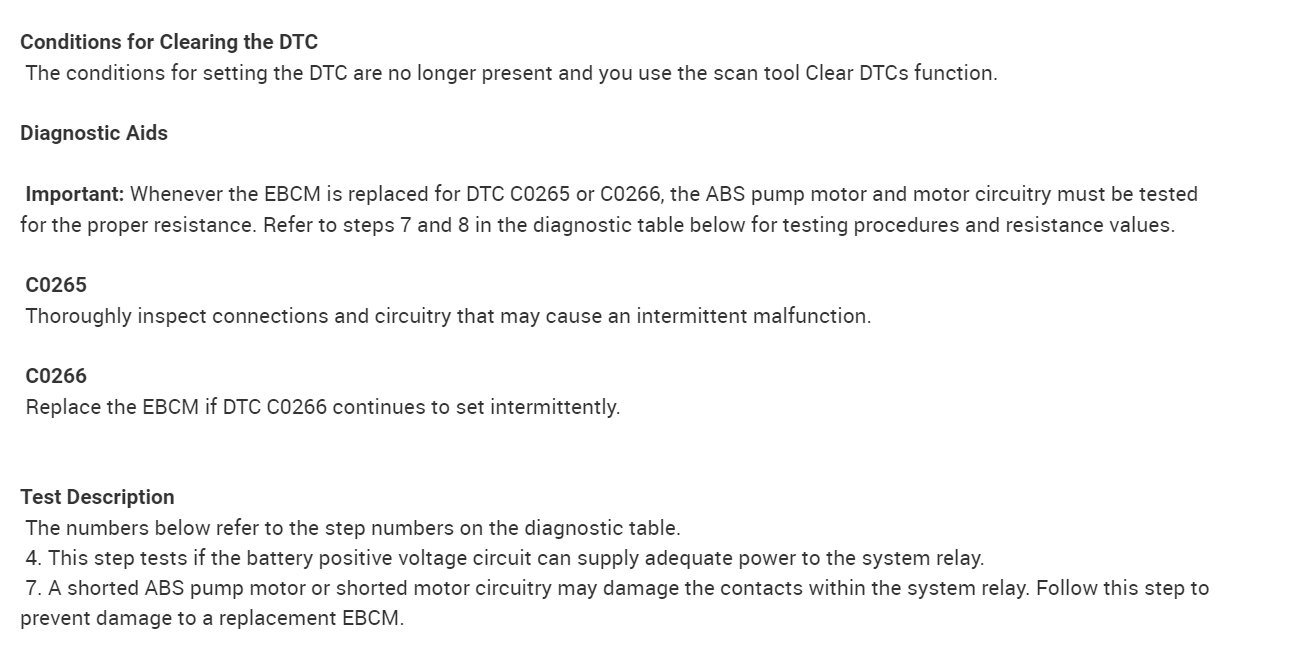

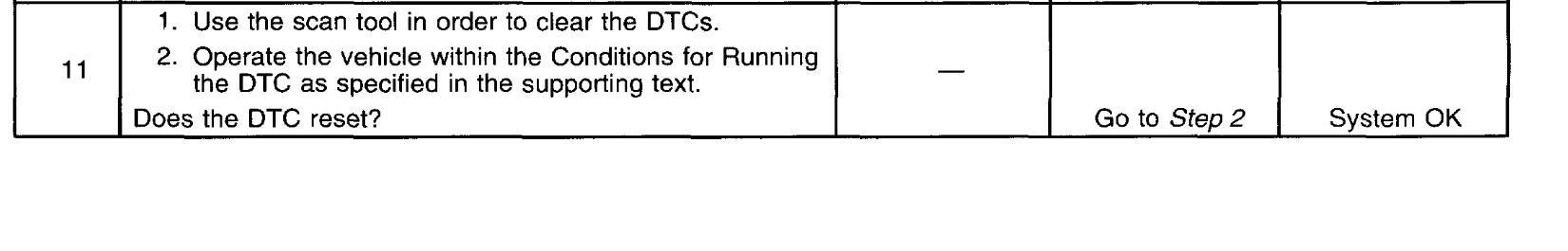

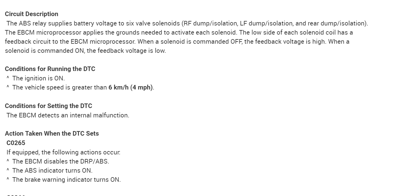

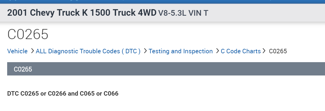

Changed the brake pads and rotors on all four wheels. Changed front hubs that came with new speed sensors installed. Brakes work great except at very low speeds. Like 1-4 mph. Pedal gets hard and pushes back as well as a growling noise. Shortly after the repair the ABS lamp and brake lamp turned on simultaneously. No fluid leakage. Checked ABS DTC’s and found that it has a Code C0265. I understand that repairs are needed but immediately after the brake service? It never occurred before the brake and hub replacement.
Monday, August 31st, 2020 AT 11:25 AM (Merged)
SCGRANTURISMO
  • 4,897 POSTS

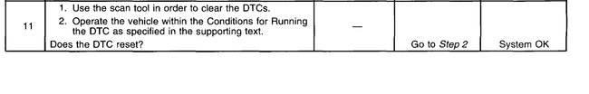

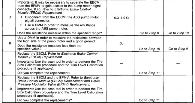

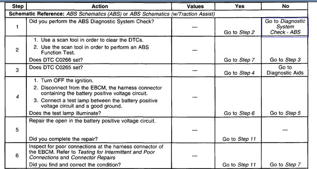

In the diagrams down below I have included the factory diagnostic troubleshooting guide for your vehicle for Direct Trouble Code (DTC) C0265. Please go through this guide and get back to us with what you are able find out for your vehicle's problem.
Thanks,
Alex
2CarPros
