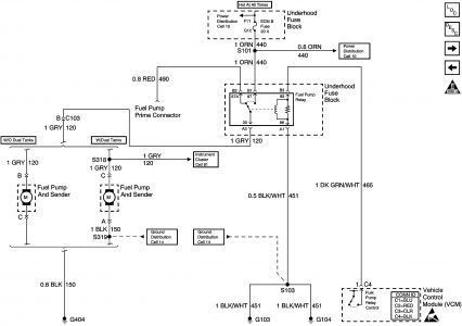

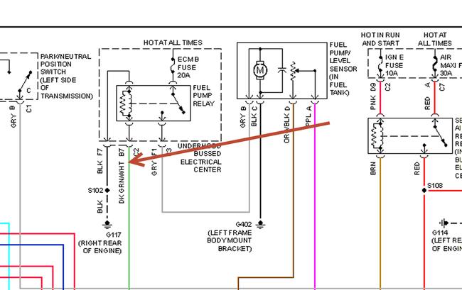

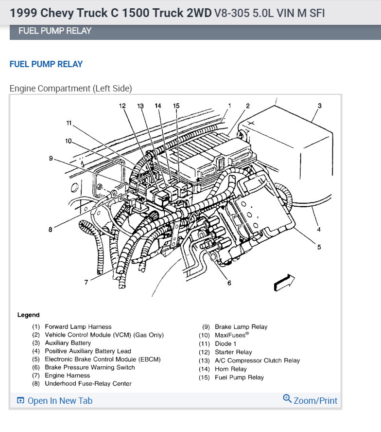

I have a 98 Z-71. It was idling and suddenly stopped. Now, when you turn the key on, the fuel pump does not make any noise. The vehicle spins over but does not fire. The relay is not clicking like it did before. I put it in another vehicle and worked fine. Is there a fuse somewhere other than the fuse box for the fuel pump? Or is there a reason why the fuel pump relay would quit working but would still be ok in another vehicle?

It doesn't sound like the relay is the problem. I think your fuel pump went out. Check fuel pump pressure. If you need the tools, most nationally recognized parts stores will rent them to you.
Let me know what pressure you get.
