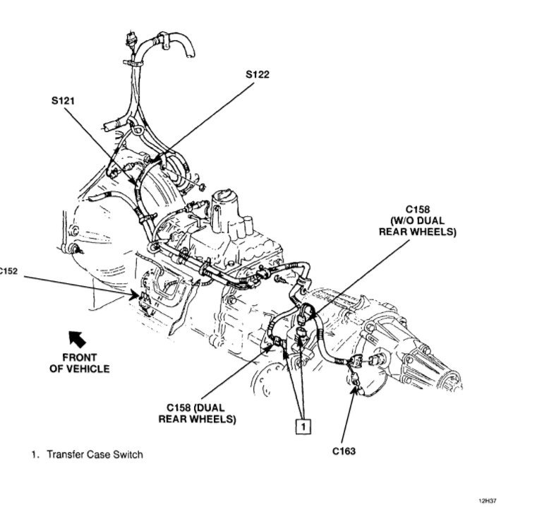

Yes, two things go wrong with these cars, either the switch on the dash goes bad or the shift actuator. You can remove the actuator and then use the switch with the key on to see if it move the way it should.
Here is a diagram to help you get the job fixed.

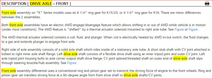

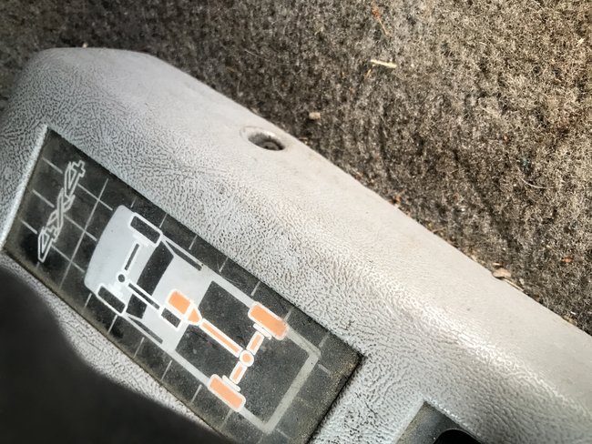

SEAN0308
  • 21 POSTS

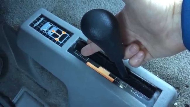

Hi thanks for the response. I have the actual floor shifter I don't know if this makes a difference. This is what it looks like in 4L. It partially engages. Yeah I am doing better I had an open hernia surgery. I don't know if your son had laparoscopic surgery or not. The open hernia surgery was terrible. But I hope he is doing well. I can't get to involved. But I will try my best. Thanks. Here is a picture of what I have for 4wd. The second picture was online but it is exactly the same thing. Thanks.

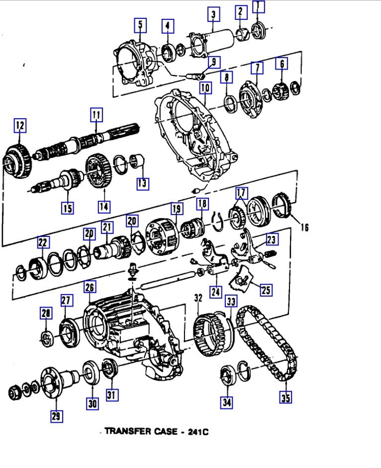

KEN L
  • MASTER CERTIFIED MECHANIC
  • 42,960 POSTS

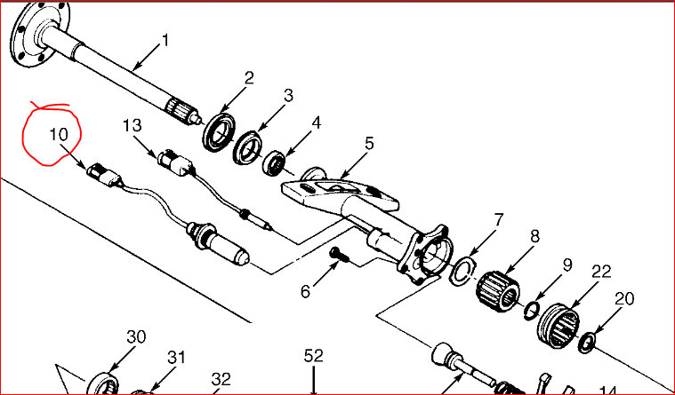

Yep sorry about that, it looks like something has gone wrong inside the transfer case. Here is an exploded view of the unit if you would like to take it apart to see what's going on. The fork slides usually wear out not allowing it to shift to 4L. Much better chance it's the thermal actuator in the front axle! Much cheaper and very very common! That's what lights up the shifter console also. Still engages the transfer case just that the front axle doesn't engage. Check out the diagrams (Below). Let us know what happens and please upload pictures or videos of the problem.

So just an update: I took it to a friend of mine. He is a mechanic. There was no power getting up to the actuator. He traced the wires back to the transfer case switch. Their was no power at all. He took the switch out and when he tested the switch it was giving weird readings. He had a probe and unhooked the actuator and it powered the actuator and it worked. The 4wd light up so he suggested the transfer case switch and also the actuator. So I got both. He put the switch in then put the actuator in. He got power to the actuator. But he had to use a ground on his meter because their was no ground getting to it. After he did that it showed 12 volts. He put everything together we started it and had no luck. So he cut one of the wires on the connector that connects to the actuator plug. And he grounded it out to one of the starter bolts. Now it works. We put the old switch back in and that was bad so we just put the new transfer case switch in and it worked. The old actuator might have been good but I just wanted to replace it since I already had it. I don't know if the ground is a problem on these trucks or not. But it works now. Thanks for all the help.

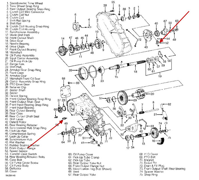

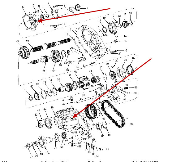

HMAC300
  • 48,601 POSTS
There are two different types borg warner and New venture. Do you know which you have? The first pic is a new VEnture and the 2nd a borg warner. There are 3different types of borg warner and 2 different types of newventure but the electrical shold be similar in each case

I have attached a few pictures that include a description of how the actuator engages your front differential when put into 4x4 mode. This is an electronic actuator and is not vacuum operated. In the picture I circled the actuator in red. These actuators are prone to failing. Hope this helps and thanks for using 2CarPros.

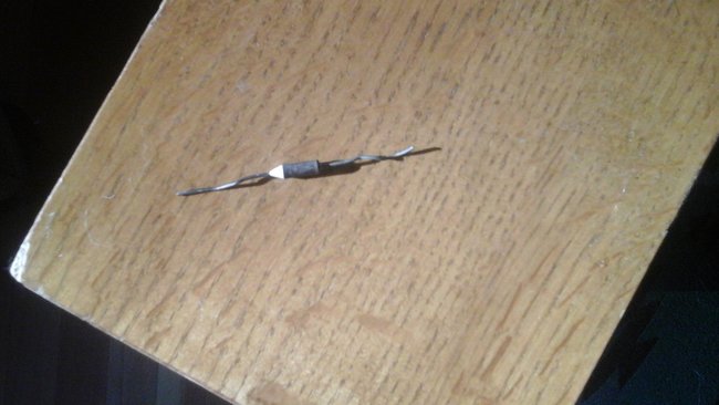

RAYDAVIES
Thanks Danny. I ordered a new actuator.
On a different subject:
I would like to repair my blower motor resistor by replacing the thermal fuse but I can not read the writing on the old fuse. I think it is 228 degrees Celsius but it is quite worn off. Do you by chance know which replacement thermal fuse I should use on the blower resistor?
