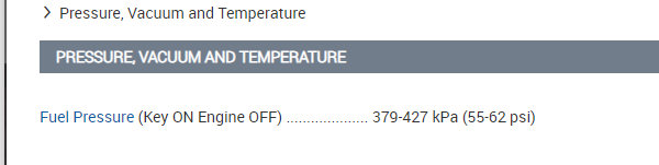

Engine will turn over but will not start. Plenty of fuel pressure at fuel rail and lots of spark from spark plug I removed. I also noticed plug was very dry? When I turn key forward I hear fuel pump turn on. Also tried spraying starting fluid into intake still no sign of starting. Wasn't able to remove and test any other plugs do to limited space. If you have any tips I would greatly appreciate it. Thanx

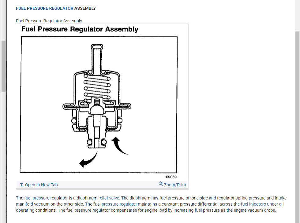

Even though there is pressure at the rail, I am thinking the best thing to do is confirm the pressure is actually high enough to start the engine.
This engine actually requires almost 60 PSI of pressure which is a pretty high amount of pressure so this may be a regulator issue.
Basically this is responsible for maintaining proper pressure at the injectors so let's start with checking it while it is cranking and see what it is.
Please see below for more info.
However, if this checks out and fuel and spark are good then we need to check the compression.
Please run through this and let us know what you find with this and we can go from there.
