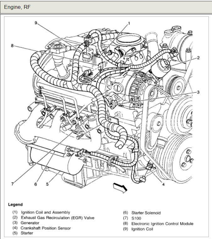

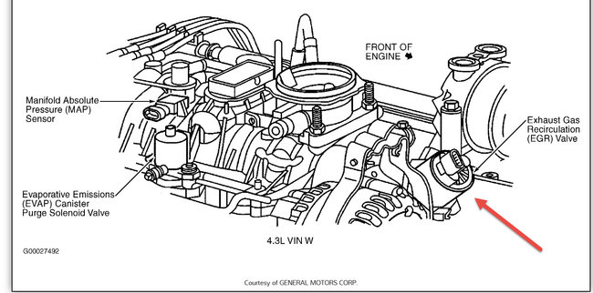

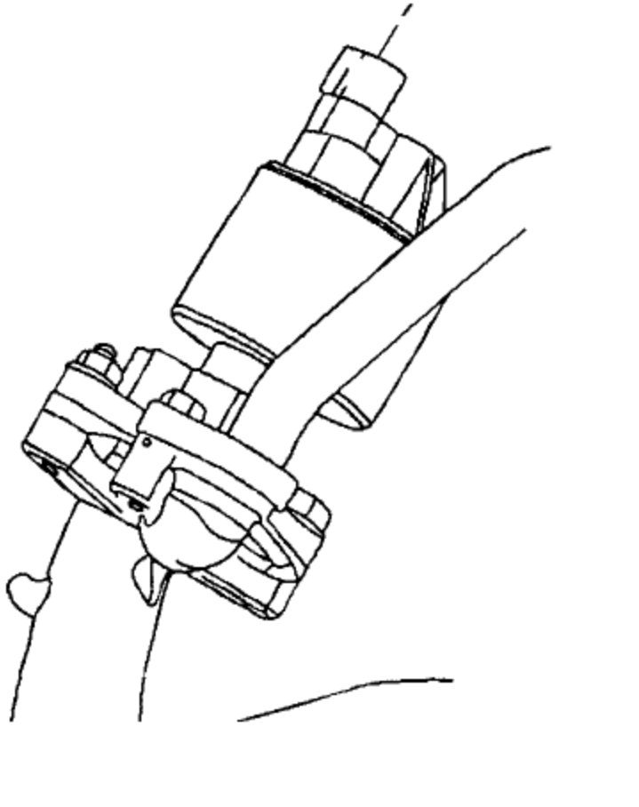

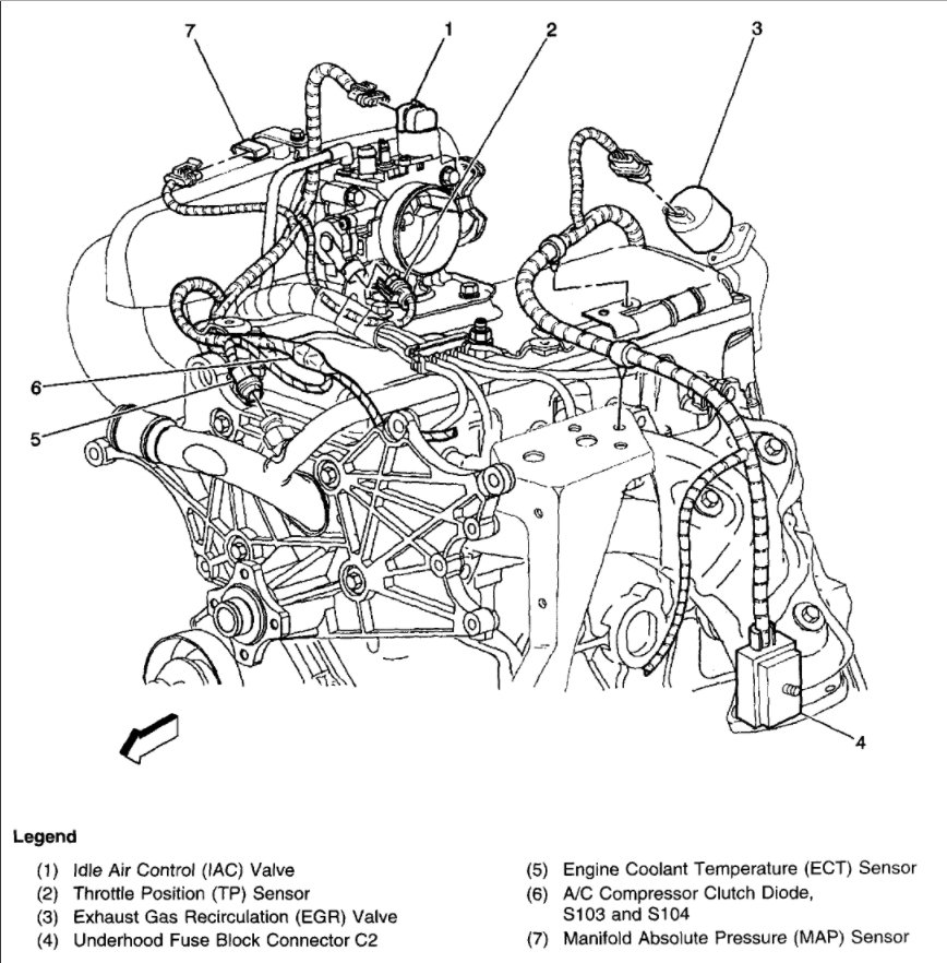

BBQ
  • 1998 CHEVROLET S-10
Four cylinder two wheel drive automatic 155,000 miles.
Where is the EGR valve located on the 2.2 liter four cylinder Vortec engine?
+1
Wednesday, November 29th, 2017 AT 4:59 PM (Merged)
KEN L
  • MASTER CERTIFIED MECHANIC
  • 55,469 POSTS
The EGR valve is located at the rear of the engine on the 4 cylinder and at the front of the engine for the 6 cylinder.
Here is a video on how to test the EGR valve check it out.
https://youtu.be/DqUCbbKdWf4
Here are the location diagrams (below).
