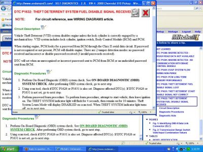

I have a 2000 chevy s10 dies while driving takes about 20 minutes for it to start back up codes read theft system fuel disabled, fuel system to lean bank 1, fuel system lean during accel ckp sensor, secondary air injection, I replaced ckp sensor, truck still dies, help please, just started job this week been laid off for 3 months need truck to work
