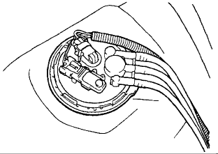

when im changeing the pump were does the o-ring go in the tank on that lil lip or on the pump its self

Removal Procedure
WARNING: To reduce the risk of fire and personal injury that may result from a fuel leak, always replace the fuel sender gasket when reinstalling the fuel sender assembly .
1.Remove the negative battery cable.
2.Relieve system fuel pressure. Refer to Fuel Pressure Release Procedure.
3.Drain fuel tank. Refer to Draining Fuel Tank .
4.Remove the fuel tank. Refer to Fuel Tank .
Important:
*The modular fuel sender assembly may spring up from its position.
*When removing the modular fuel sender assembly from the fuel tank, be aware that the reservoir bucket is full of fuel. It must be tipped slightly during removal to avoid damage to the float. Discard fuel sender O-ring and replace with a new one. Carefully discard the reservoir fuel into an approved container.
5.While holding the modular fuel sender assembly down, remove the snap ring from designated slots located on the retainer.
Installation Procedure
1.Install a new O-ring on modular fuel sender to tank.
2.Align tab on front of sender with slot on front of retainer snap ring.
3.Slowly apply pressure to top of spring loaded sender until sender aligns flush with retainer on tank.
Important: Be sure that the snap ring is fully seated within the tab slots.
4.Insert snap ring into designated slots.
5.Install the fuel tank. Refer to Fuel Tank .
6.Lower vehicle.
7.Refill tank.
8.Inspect for fuel leaks through the following steps:
8.1. Turn the ignition to the ON position for 2 seconds.
8.2. Turn the ignition to the OFF position for 10 seconds.
8.3. Turn the ignition to the ON position.
8.4. Check for fuel leaks.
