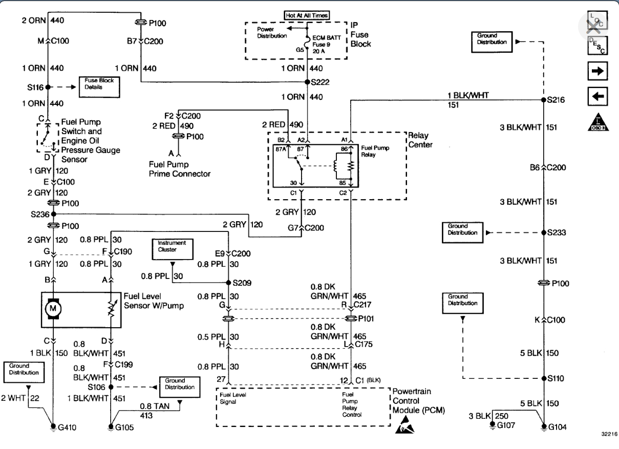

Fuel gauges stays on full
JASONWOODARD
  • 1996 CHEVROLET S-10
  • 4 CYL
  • 2WD
  • MANUAL
  • 99,000 MILES
I put new fuel pump and new cluster still didn't help fix. What is wrong with it?
Thursday, September 17th, 2009 AT 7:53 PM
SQM
  • 6,383 POSTS
If you have replaced the fuel level sensor as well as the gauge, then the issue is likely a faulty wire that is triggering the gauge to stay on full.
Tracing the fuel level sensor wire should help to determine the issue.
I have attached the fuel pump wiring schematics below. Take a look at the part that shows the level sensor to the gauge. The issue is likely that wire.
