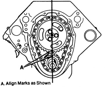

I try looking for the timing marks and cant find them any where. Where should I look at?

Is this 2.2L engine? Diesel or gasoline engine? Also is this s-10 pickup or s-10 blazer?

4.3 pickup truck gas

Below are your timing marks. Let me know if you need further assistance.
https://www.2carpros.com/forum/automotive_pictures/261618_0900c152801c8da6_1.jpg

Its a belt drive

The 2.2L diesel engine is the only '88 s-10 pickup equipped with a timing belt. All others were equipped with timing chains.

Okay. Serpentine belts do not have timing marks. Only the timing belt/chain has timing marks and your vehicle is equipped with a timing chain. You do not have to worry about timing marks for the serpentine belt.
