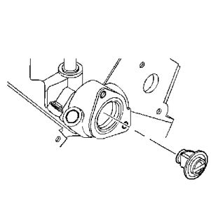

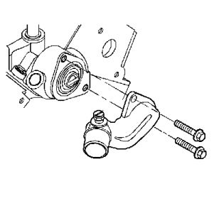

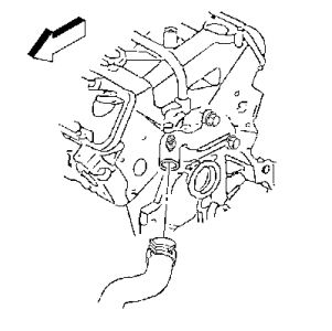

Temp gauge is not working but the rest of gauges are? Is this a sensor or the actual gauge?
Tuesday, December 31st, 2019 AT 10:39 AM (Merged)
TOMSHANTY
  • 34 POSTS
Sounds like either the coolant temp sensor is bad or the gauge. The manual shows the coolant sensor is what the gauge uses as well as the computer. If it is accompanied b the check engine light I would go after the coolant sensor. This vehicle also had issues with corrosion in the connector for the sensor
Its located in the back of the cylinder head
See the diagram below
