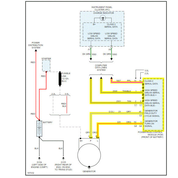

KANPOL
  • 2005 CHEVROLET MALIBU
  • 3.5L
  • V6
  • 2WD
  • 186,018 MILES
Battery went dead bought new one. System locked up, did the 10-minute reset it ran two days now just clicks.
Friday, August 28th, 2020 AT 9:26 AM (Merged)
  • 52,797 POSTS
Good afternoon,
Do you have a voltmeter to do some tests on the battery and charging system?
https://www.2carpros.com/articles/how-to-charge-your-car-battery
We need to see if the alternator is working.
I attached a wiring diagram of the charging system. If you have a voltmeter, we can do some checks.

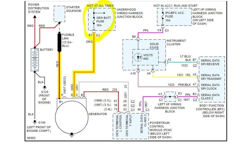

JOE ALLEN4
  • 1998 CHEVROLET MALIBU
  • 6 CYL
  • 2WD
  • 150,000 MILES
I've replaced the battery, I've replaced the alternator. Driving the car with a brand new battery the battery only lasted forty five minutes before it died. I have extremely limited knowledge of vehicles everything I'm learning how to do on this car I'm learning on YouTube so please help. Could there be a short somewhere between the alternator and the battery? How do I tell if the alternator itself is even getting the correct amount of power?
  • 52,797 POSTS
Good evening,
Do you have a voltmeter to do some checks?
https://www.2carpros.com/articles/how-a-car-electrical-system-works
You need to test the voltage at the battery with the engine running.
I attached a diagram of the charging system for you. Check the fuse I circled for power on both sides of the fuse.
