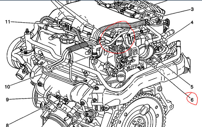

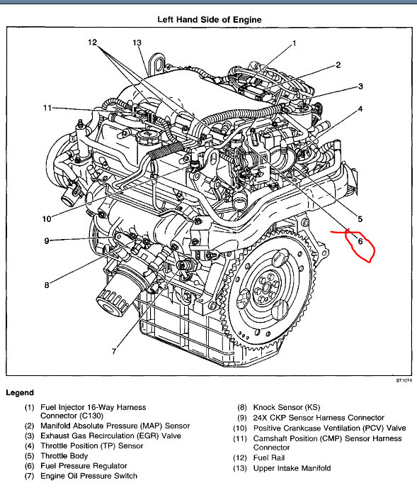

Where is the fuel pressure regulator located?

The fuel pressure regulator is located on the left side top of the engine. I've attached 2 pictures below and circled in red which is component number 6. The second picture I blew up larger for you. Hope this helps and thanks for using 2CarPros.
