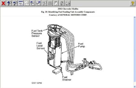

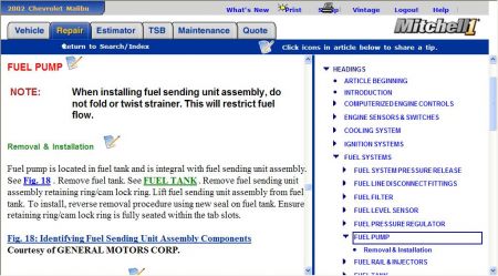

How does one access the fuel pump? Is there an access hole somewhere?
Tuesday, March 18th, 2008 AT 3:01 PM
2 Replies
MASTERTECHTIM
MECHANIC
4,750 POSTS
UNFORTUNATELY THERE IS NO ACCESS HOLE OR PANEL. To replace fuel pump you must remove the fuel tank. Hope this helps
Tuesday, March 18th, 2008 AT 3:36 PM
MECHANIC
75,992 POSTS
There's no access hole the fuel tank has to come down
BTW why are you replacing the fuel pump?
