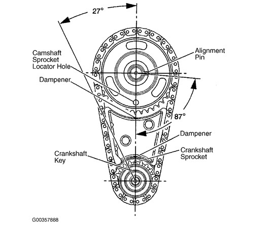

Hey I recently changed on my 1998 lumina 3.1 one of my bent exhaust valve and pushrod and changed all gaskets from head up. I tried starting it and it wouldn't start at all. It cranks but it doesn't start. One thing I notice was after trying to start the car I took out a spark plug which were brand new and notice that they were a little wet and it smelled like gas. Another thing I noticed was right where I pour the engine oil in I'm able to see like 2 or 3 rocker arms and the spring and stuff and when I had someone crank it for me the rocker arm and all that were not moving at all. So u think it could be out of time? Are the rocker arms suppose to move while the engine is attempting to start or do they start moving when the engine starts. What do you guys think?

Check your timing chain and sprockets. Those rocker arms should move when cranking.

K. One think I noticed when it was apart was that number one cylinder is not at the top. It's at the bottom. That's not normal right? Thank you for your answer. How easy is it to put it back to time to align the camshaft and crankshaft.

The timing chain is in the diagram.
