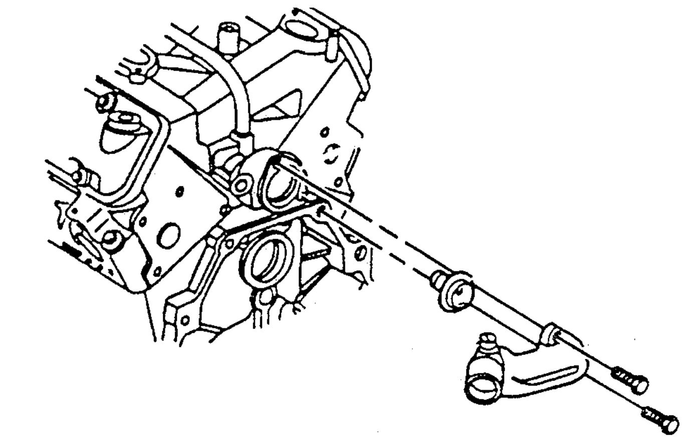

I have a 97 chevy lummina with a v6 3.1 engine. It over heats within about 5 minutes. The radiator remains cool to the touch. I already replaced the thermostat. And I think the pump may be working because there is pressure.
Could it be another faulty thermostat?
Its my sisters car and she said she had a radiator leak and put some readiator stop in it a few times. If she put a lot of this in her vehicle could this clog or brake something?

Could be the thermostat. or the fact of there being countless bottles of stop leak in it. that gums up lines. pumps and cooling fins on the radiator. flush out the system and replace the thermostat. Be sure to open the air bleed on the thermostat housing (See pic below) otherwise it will air pocket and overheat. There may be one on the hard coolant line that runs across the top of the engine in front. If this has been done and it still overheats you may need to chemical test it for a blown head gasket

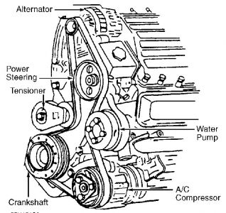

My A/C clutch/pulley was making a high whining noise so I figured it was about to go out so instead of spending 100+ dollars to put on a new compressor, I measured the serpentine belt to where I could bypass it, I did. And now (after double checking the belt route, ) My car overheats real bad. Could I have reversed the water pump by any chance?

IF it is overheating now and wasn't before the by-pass it sure sounds like a mis-routing or slippage.
Are you working off
a diagram to check it?
I don't think you can by-pass it like that.
The belt is not going to touch the water pump enough or if you wrapo it around it will spin the wrong direction.
https://www.2carpros.com/forum/automotive_pictures/30961_31_1.jpg
3.1?
