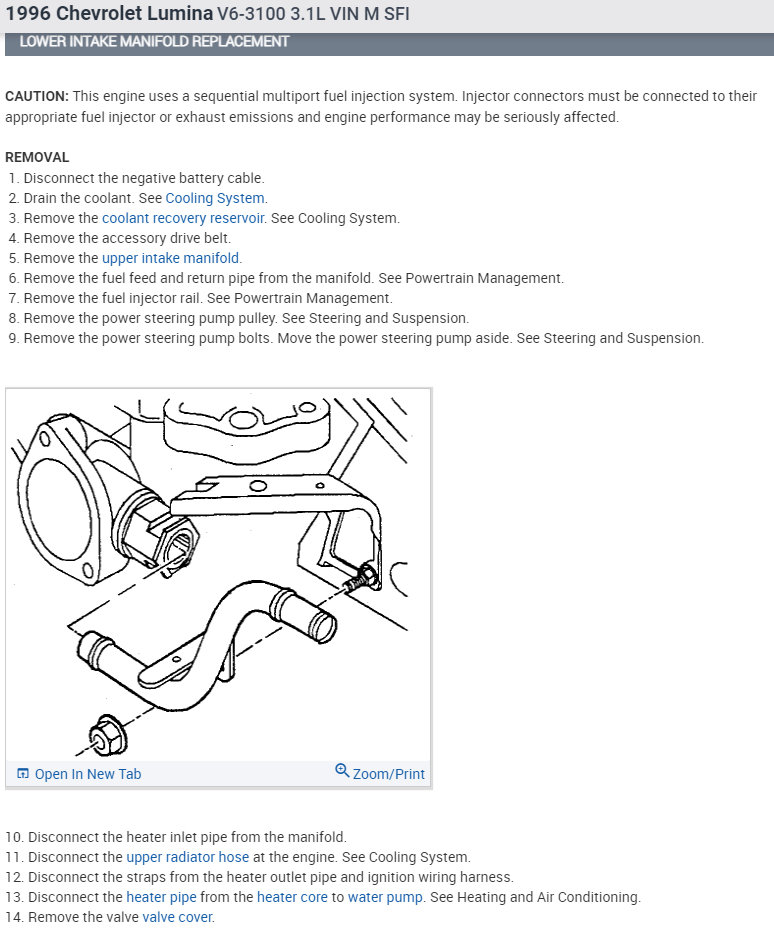

I replaced intake gaskets and put everything back and now it wont start
Saturday, March 15th, 2008 AT 6:53 PM

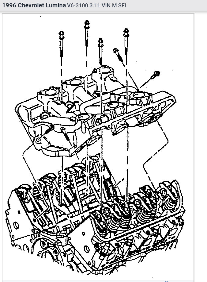

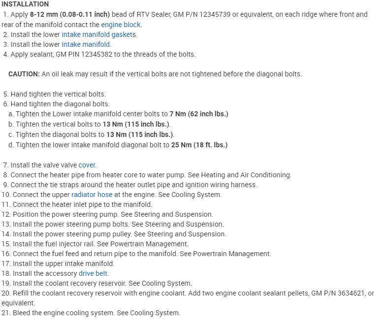

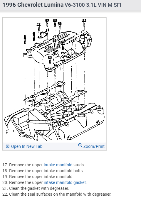

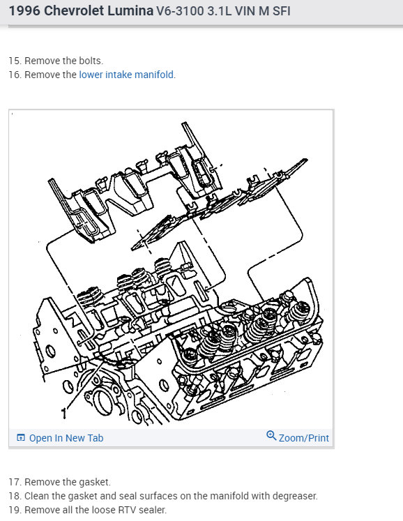

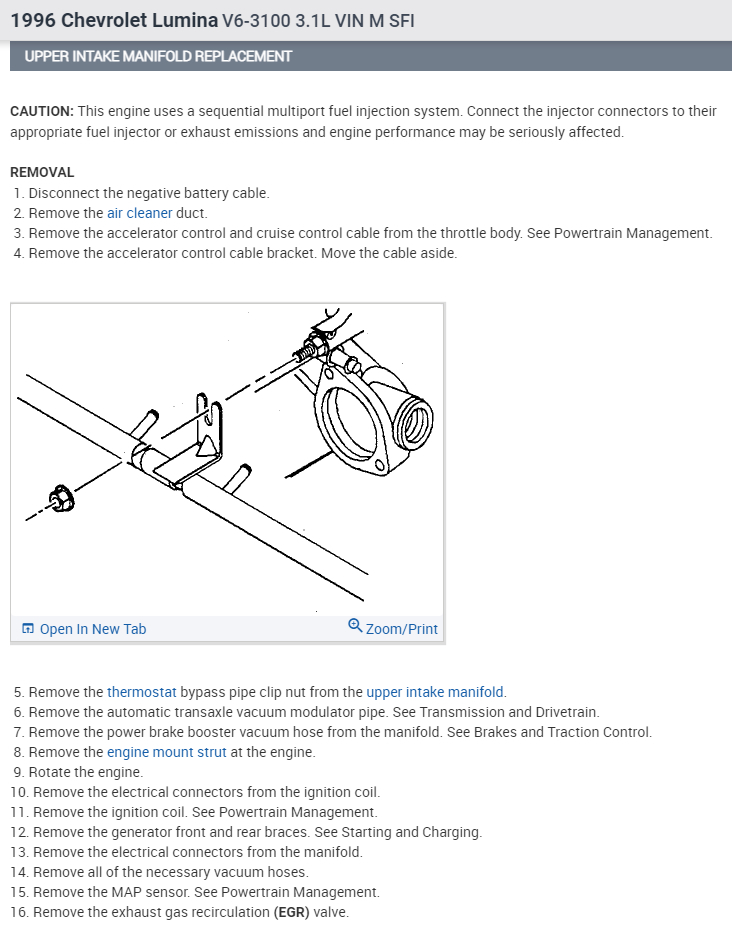

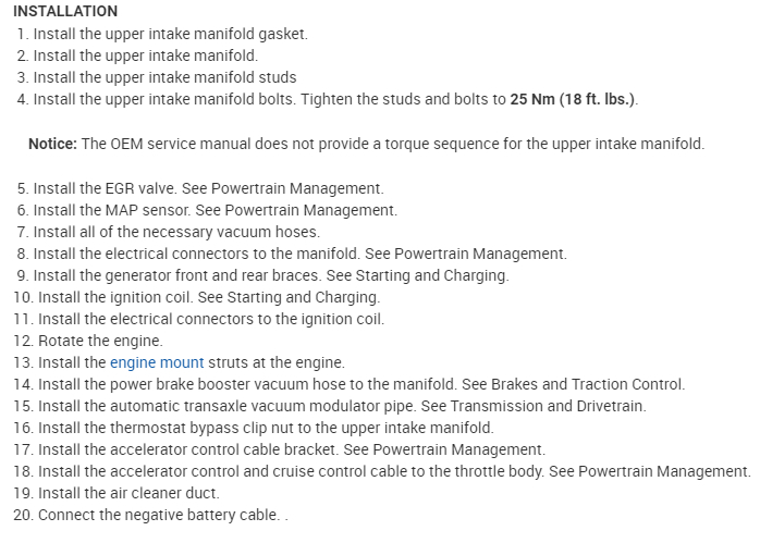

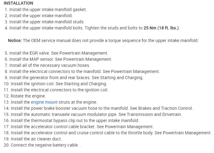

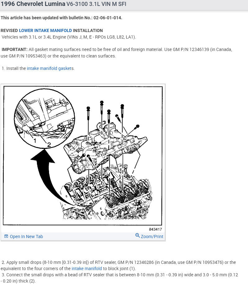

If this no start issue started after the gasket replacement, it is likely that something might not have gotten installed properly.
https://www.2carpros.com/articles/replace-intake-manifold-gasket
I have attached the complete replacement procedure below. Take a look at it and see if you might have missed a step or something got left unplugged.
