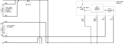

No dash lights coming on. Think it is the headlight switch cause it has done this before and played with the switch and they came on.

You may be correct about the headlamp switch? In the wiring diagram, gray wire is voltage to the instrument lamps, black wire is ground.
