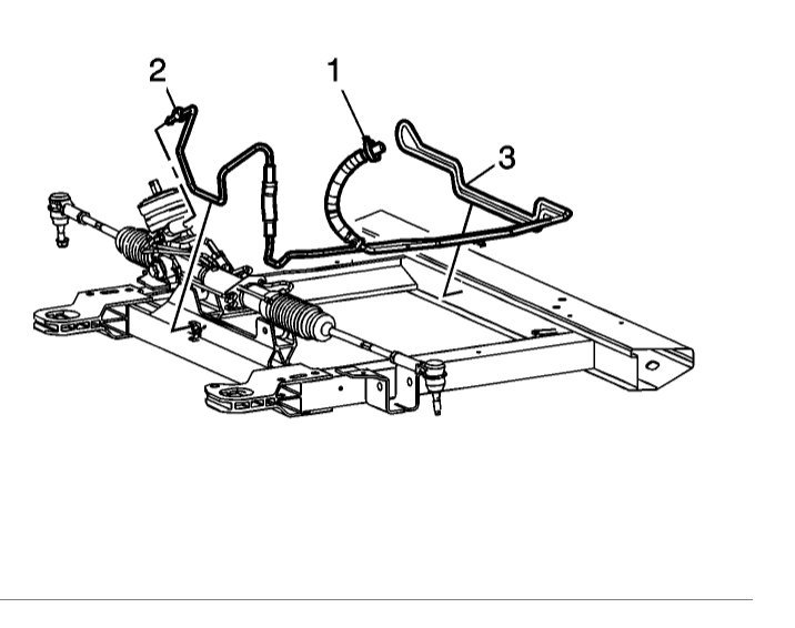

Trying to flush the power steering fluid, and the documentation says to remove the power steering fluid return hose - where is it? Help greatly appreciated. I have sucked what fluid I could out already, but it was less than 12 oz. I just obtained the car from a guy who drove it 300 miles a day, so am changing all the fluids and filters.
Friday, May 28th, 2010 AT 7:21 PM
14 Replies
  • 75,992 POSTS
See location no.1
https://www.2carpros.com/forum/automotive_pictures/12900_ps_4.jpg

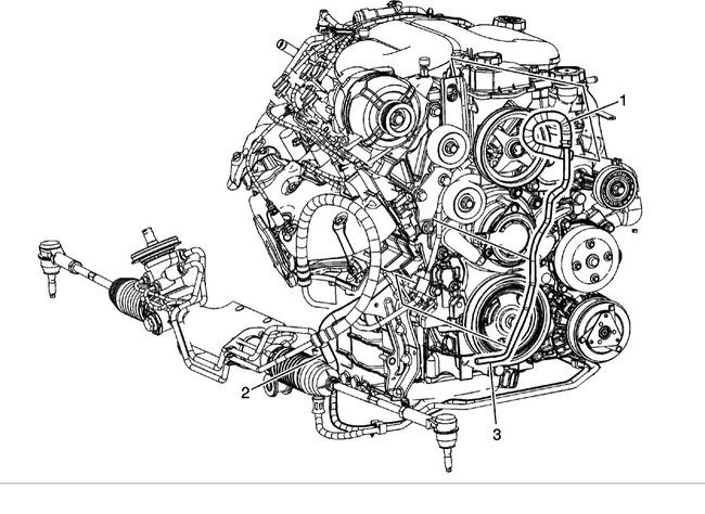

KEN L
  • MASTER CERTIFIED MECHANIC
  • 42,959 POSTS

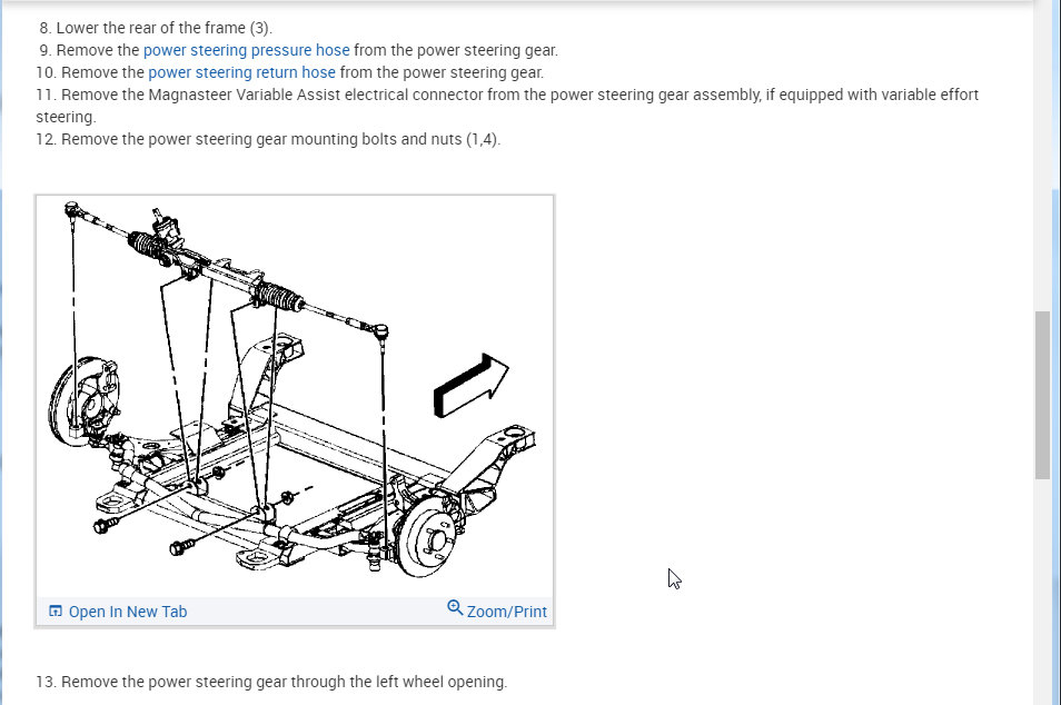

You will need to jack the car up first
And you will need line wrenches to break the lines looses without rounding them.
https://youtu.be/HNlvgp_YfQ0
Here is a video of a power steering line being done.
https://youtu.be/BGBUv5r9fk0
Here are the diagrams (below)

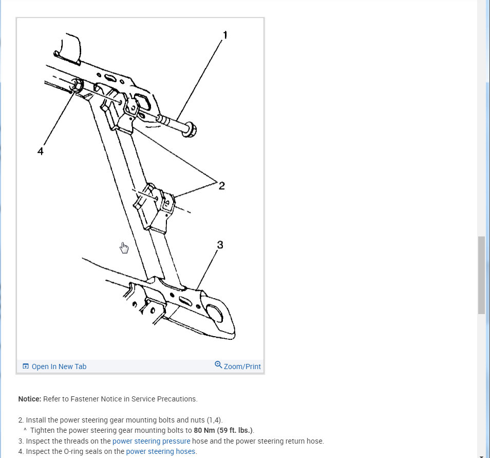

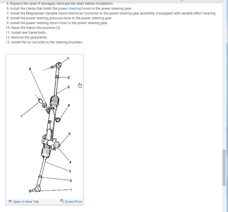

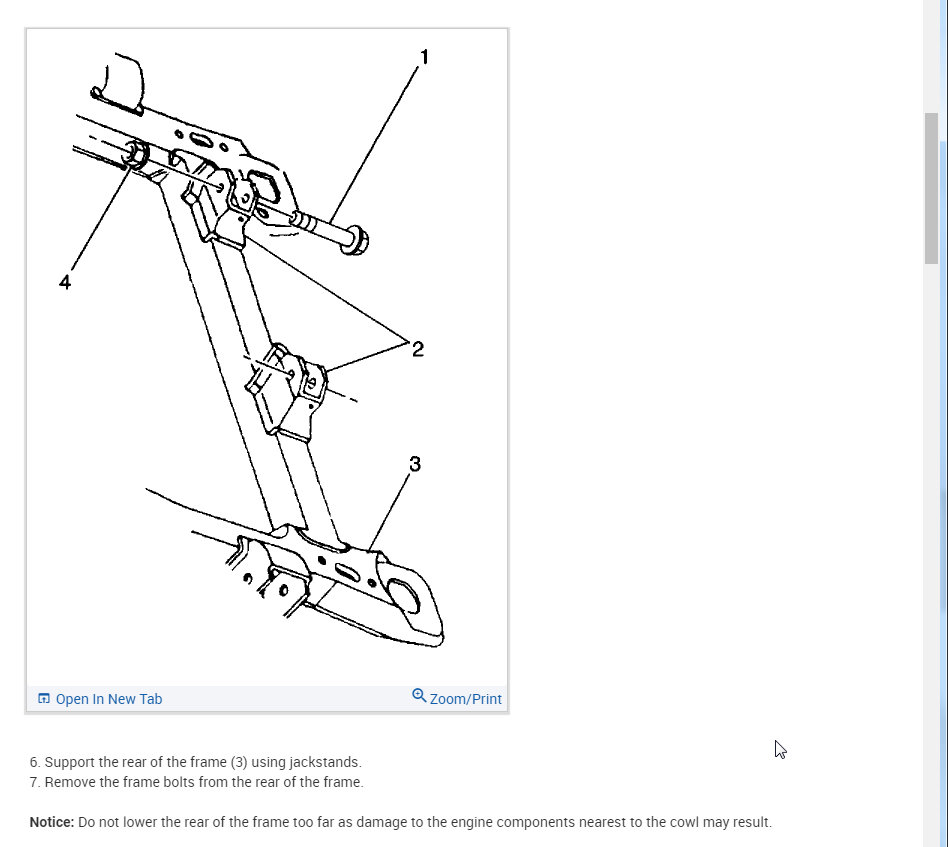

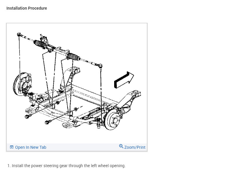

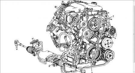

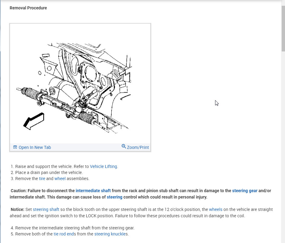

AARON JOHNSON
I have a 2005 Impala and saw what you posted for a 2004 and the diagrams look identical to what I am seeing in my car. My question is what is the best way to get the line connections at the gear? From underneath or down through the top? Any tips you could share would be appreciated.
+1
Saturday, June 20th, 2020 AT 10:53 AM (Merged)

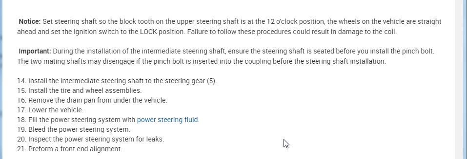

I attached the entire procedure for replace the steering gear. From my experience, I normally do this on a lift and always get them from underneath. So I am sure you can find other people that may say from above but I do it from underneath.
Let me know if you need more info. Thanks

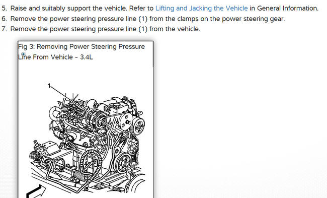

Dear Sirs,
I need to replace the high pressure power steering hose on my car is has a 3.4 liter engine. I need to know how difficult it will be and if you have a diagram of how to do it and what needs to be removed?

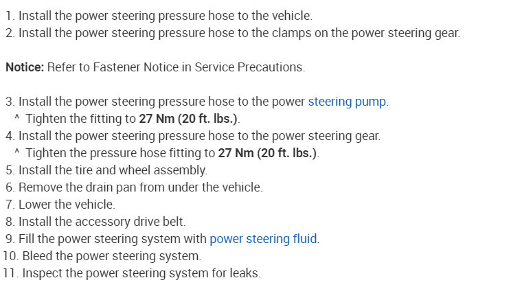

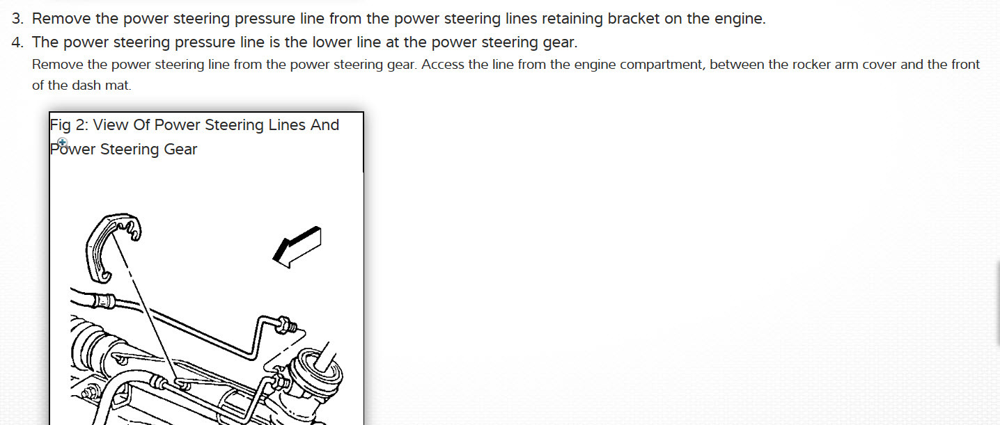

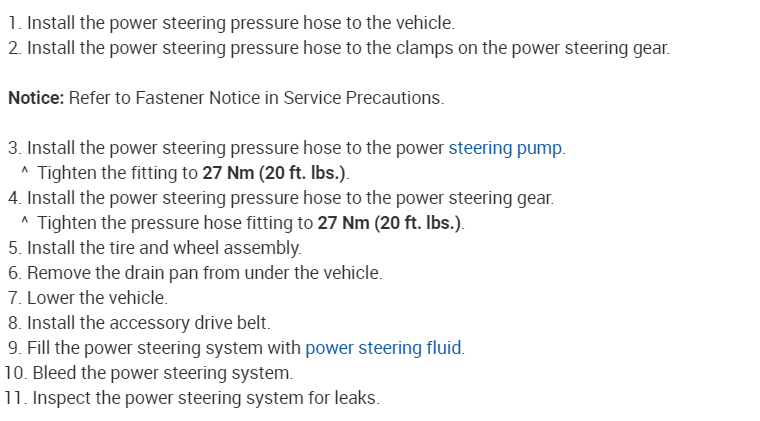

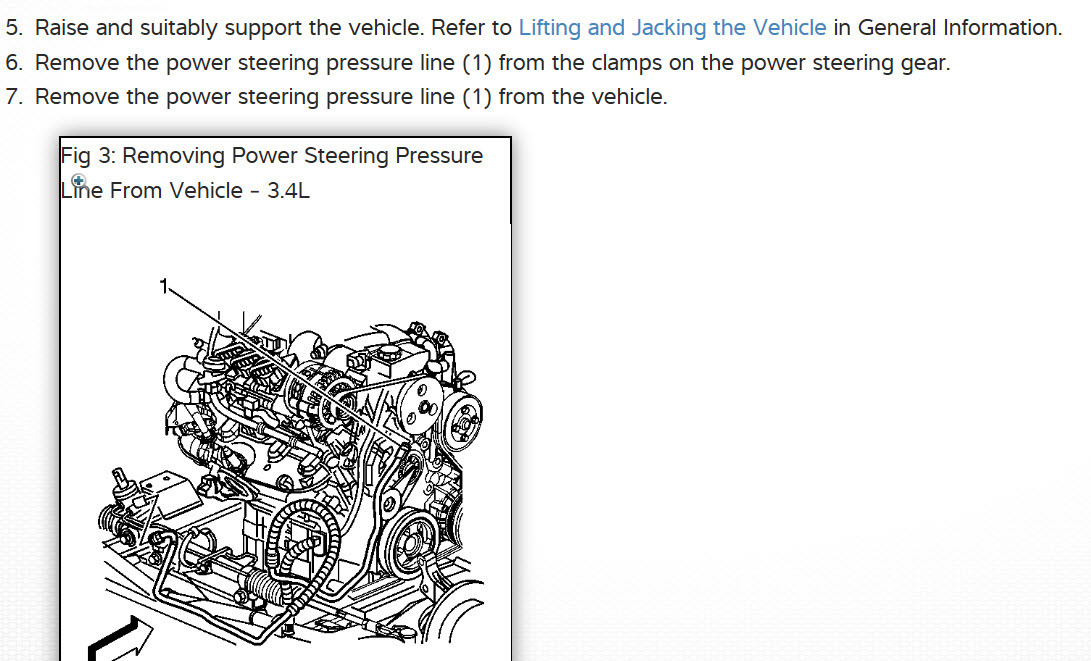

FACTORYJACK
  • 4,159 POSTS

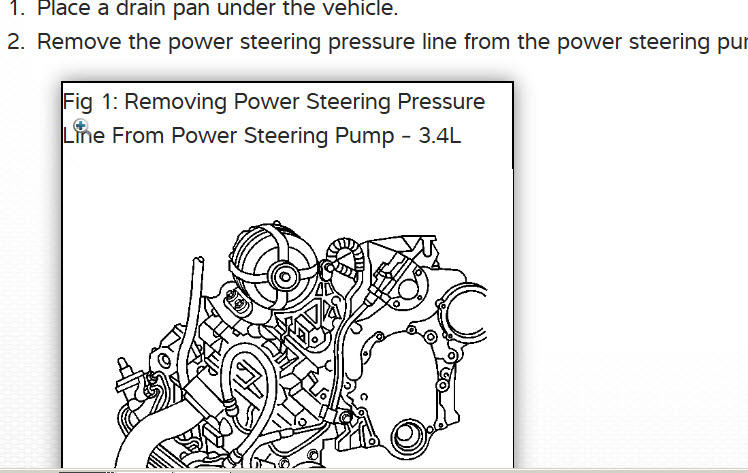

Here is what I have from GM service information.
Power steering pressure pipe/hose replacement (3.4L).
Removal procedure:
Place a drain pan under the vehicle.
https://www.2carpros.com/forum/automotive_pictures/309872_515071_1.jpg
Remove the power steering pressure line from the power steering pump.
Remove the power steering pressure line from the power steering lines retaining bracket on the engine.
https://www.2carpros.com/forum/automotive_pictures/309872_417973_1.jpg
The power steering pressure line is the lower line at the power steering gear.
Remove the power steering line from the power steering gear . Access the line from the engine compartment, between the rocker arm cover and the front of the dash mat.
Raise and suitably support the vehicle. Refer to Lifting and Jacking the Vehicle in General Information.
https://www.2carpros.com/forum/automotive_pictures/309872_469241_1.jpg
Remove the power steering pressure line (1) from the clamps on the power steering gear.
Remove the power steering pressure line (1) from the vehicle.
Installation Procedure
https://www.2carpros.com/forum/automotive_pictures/309872_469241_2.jpg
Install the power steering pressure line (1) to the vehicle.
Install the power steering pressure line (1) to the clamps on the power steering gear.
Lower the vehicle.
https://www.2carpros.com/forum/automotive_pictures/309872_417973_2.jpg
Notice: Use the correct fastener in the correct location. Replacement fasteners must be the correct part number for that application. Fasteners requiring replacement or fasteners requiring the use of thread locking compound or sealant are identified in the service procedure. Do not use paints, lubricants, or corrosion inhibitors on fasteners or fastener joint surfaces unless specified. These coatings affect fastener torque and joint clamping force and may damage the fastener. Use the correct tightening sequence and specifications when installing fasteners in order to avoid damage to parts and systems.
Install the power steering pressure line to the power steering gear.
Tighten
Tighten the power steering pressure line fitting to the power steering gear to 27 N Â m (20 lb ft).
Install the power steering pressure line to the power steering lines retaining bracket on the engine.
https://www.2carpros.com/forum/automotive_pictures/309872_515071_2.jpg
Install the power steering pressure line to the power steering pump.
Tighten
Tighten the power steering pressure line fitting to the power steering pump to 27 N Â m (20 lb ft).
Fill the power steering system with power steering fluid. Refer to Checking and Adding Power Steering Fluid .
Bleed the power steering system. Refer to Power Steering System Bleeding .
Inspect the power steering system for leaks. Refer to Power Steering Fluid Leaks .

RBRASE
  • 20 POSTS
I am back on the road! Once again, 2carpros nailed it!

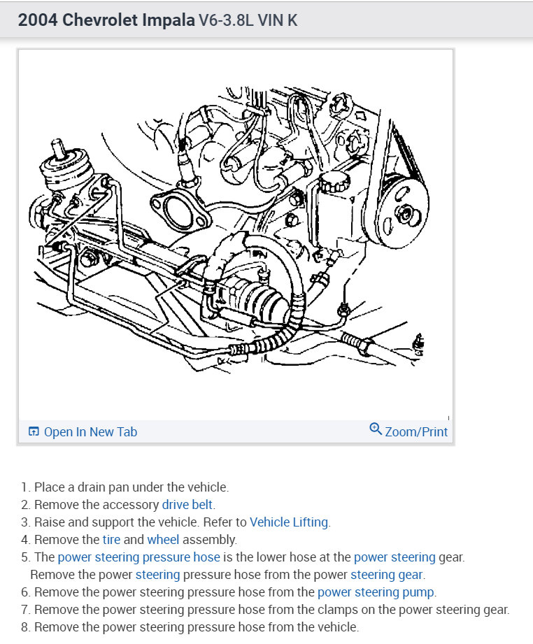

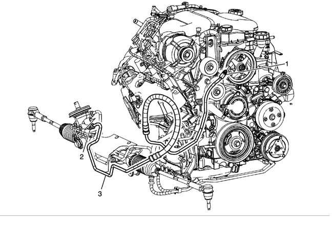

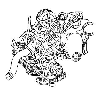

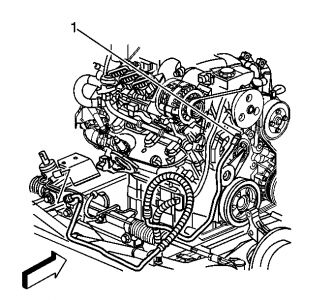

HARRY65
  • 2004 CHEVROLET IMPALA
  • 3.4L
  • V6
  • FWD
  • 120,000 MILES
My power steering return line is split and I need to know the best way to remove it. I was told it had to come out the wheel well. I dont like that sloution. This is the line that wraps around the engine. It feeds the rack and pinion I believe and goes around the front of the motor.
HMAC300
  • 48,601 POSTS
See pics
-2

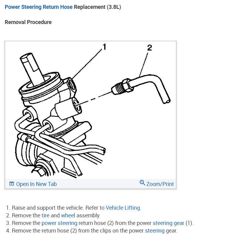

JESSE AVILA
  • 3.8L
  • 6 CYL
  • TURBO
  • FWD
  • 160,000 MILES

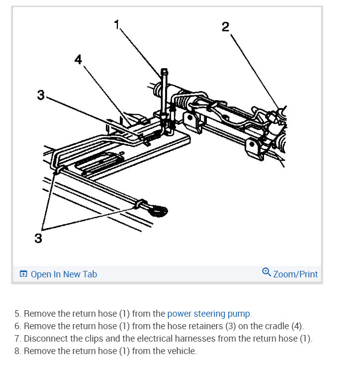

I am replacing leaking power steering return hose in my car it is the SS model. It has gotten me to the point where I think I am going to blow it up from frustration of installing the new return hose. I need to know the proper way to install the new hose ASAP! I need to get my children to and from school before I get a citation for their outstanding absences. Please help me we are currently homeless and cannot even look for a place to live without our car. Any links with the procedure and detailed images would very much be appreciated.
HMAC300
  • 48,601 POSTS
See pictures if any O-rings make sure that they are installed otherwise you will get a leak. Here are instructions and diagrams to help you get the job done. Check out the diagrams (Below). Please let us know if you need anything else to get the problem fixed.
