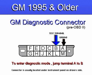

If the IAC motor is defective, would the check engine light come on?
Monday, February 2nd, 2009 AT 2:52 PM
MECHANIC
75,992 POSTS
You can confirm it if the CEL on. By doing below and counting the flashes
