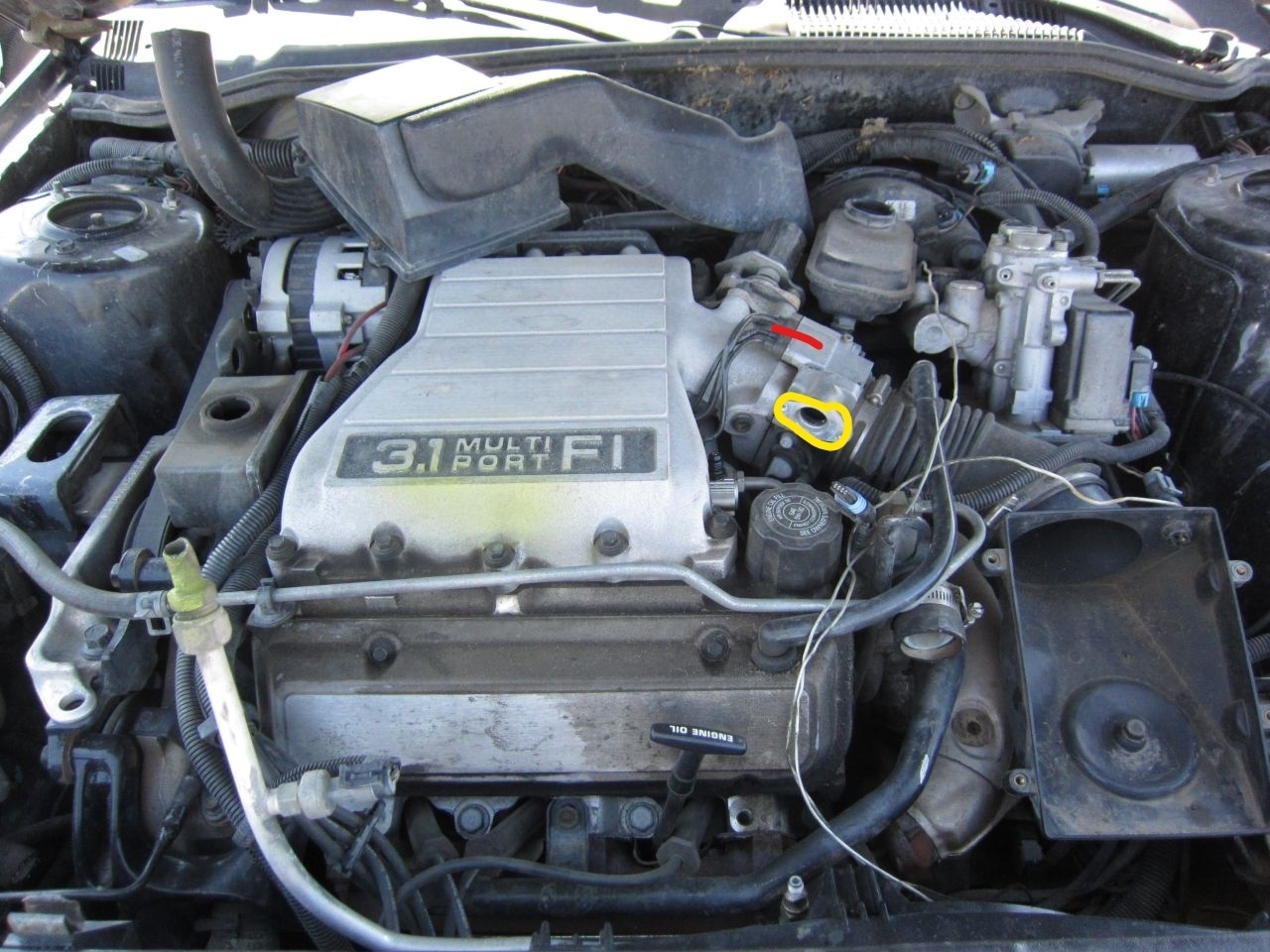

Car is idling high when starting in the morning and car is revving up and down, then car will shut off. It starts back up and when put in drive will shut off. Also stalls at stoplights. What is this part in red called? The yellow is the IAC (not my car but is the same 3.1 engine). The red line shows where one of the three black lines is cut in half. Could this be the cause of my problems?
Friday, August 10th, 2018 AT 11:50 AM (Merged)
JIS001
  • 3,412 POSTS
Can you take a picture of your engine? It does sound like a bad IAC motor.

Try cleaning out the idle air control valve and test the throttle position sensor-
