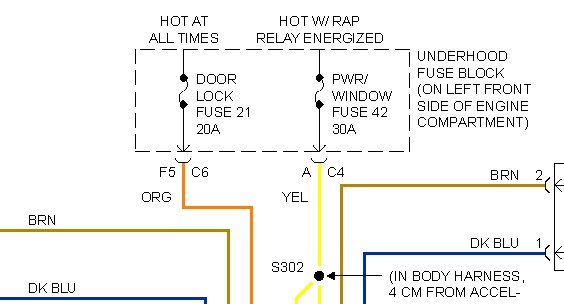

Truck when died I charge it and the driver side window and power locks wont work now

Remove both switches and check for power.

Power lock & power window control (drivers window) doesn't work

You can check some of the wiring going into the driver door on the hinge side of door. The wire harness may have a rubber boot protective covering, pull the covering back. Orange wire is voltage for door lock. Yellow wire is voltage for power window. Check for voltage on those wires, use voltage tester. Black wire is ground. You can also check fuses.
