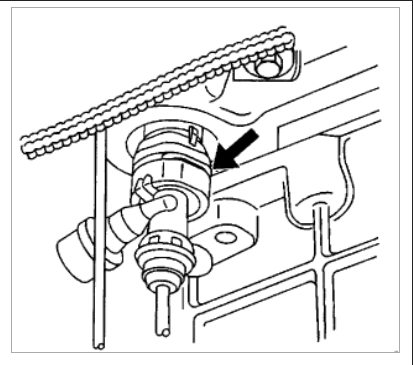

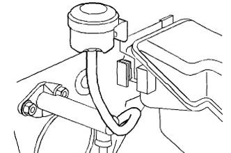

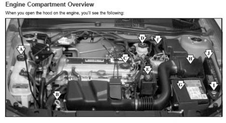

My 04 cavalier lost all clutch fluid and I'm unsure if its the clutch master cylinder or the clutch slave cylinder, I cannot find a picture or location of either?

The F arrow is for the clutch master cylinder.
https://www.2carpros.com/forum/automotive_pictures/170934_clutch_fluid_1.jpg

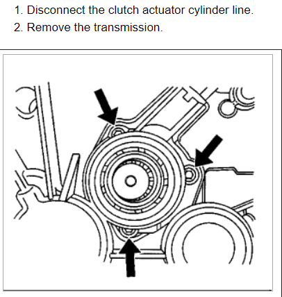

It sounds like you have a slave cylinder leaking because they go out due to the transmission vibration.
Here are guides to help you see what you are in for when changing the unit out.
https://www.2carpros.com/articles/throw-out-bearing-replacement
and
https://www.2carpros.com/articles/transmission-replacement-removal-manual
