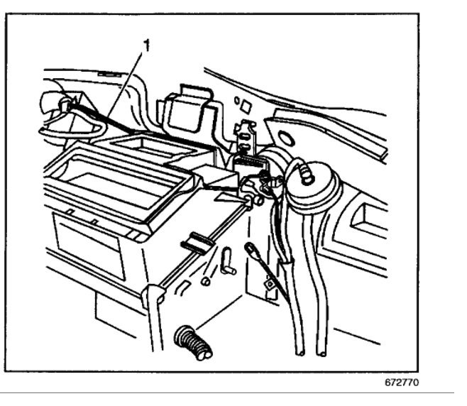

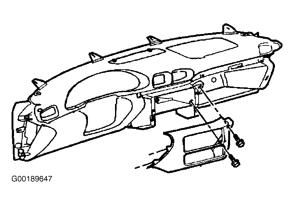

Here are some diagrams (below) of your car to help you get the job done

https://www.2carpros.com/forum/automotive_pictures/261618_Noname_1799.jpg

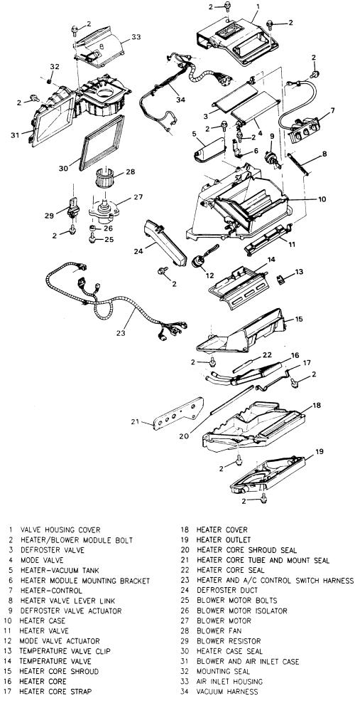

Take a look at the attached pic and let me know if it helps. It shows the entire unit in an exploded view. Hopefully, you can see something that needs removed.

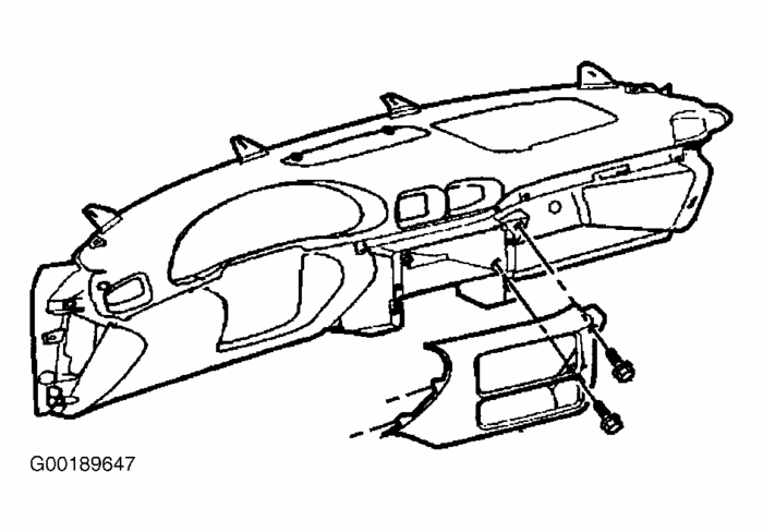

Remove the instrument panel as instructed below:
REMOVAL OF INSTRUMENT PANEL:
Remove the instrument panel cluster trim plate.

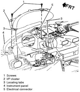

Unfasten the screws from the top of the cluster, then pull the cluster rearward to remove.
INSTRUMENT CLUSTER MOUNTING
https://www.2carpros.com/forum/automotive_pictures/261618_0900c1528003cf21_2.jpg

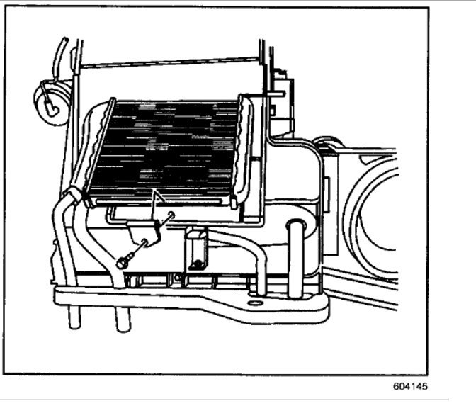

HEATER CORE AND RELATED COMPONENTS
https://www.2carpros.com/forum/automotive_pictures/261618_0900c1528003cf21_1.jpg

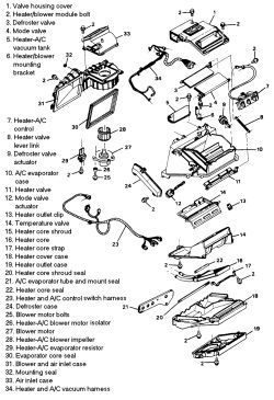

Here are the directions. Also, I have attached an exploded view of the system. I hope it helps.

Remove the instrument panel. For details, please refer to the procedure located in Body & Trim of this guide.

This is the only exploded view picture I could find of the system. I hope it helps. It shows the entire system.

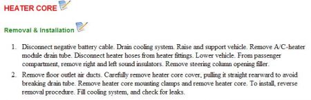

  • 75,992 POSTS

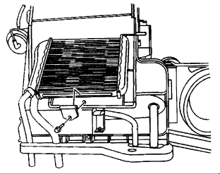

HEATER CORE REPLACEMENT
REMOVAL PROCEDURE

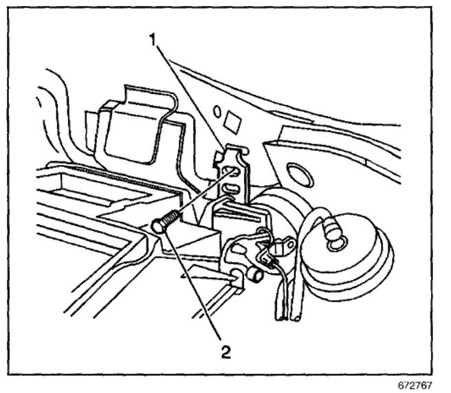

Remove the HVAC module. See: Housing Assembly HVAC Service and Repair
Turn the HVAC module over.
Remove the heater core case cover screws and cover.
Remove the heater core bracket screws and brackets.
Remove the heater core.
