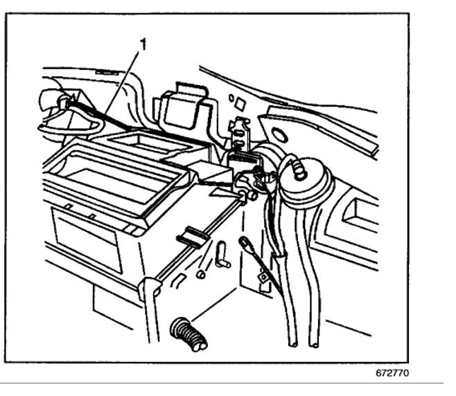

You will need to drain the coolant first and disconnect the battery. Also you will need to vacuum down and then recharge the ac system when you are done. Here is a guide for that.
Here is a guide that will give you an idea of what you are in for when doing the job.
https://www.2carpros.com/articles/replace-heater-core
Here are some diagrams (below) of your car to help you get the job done

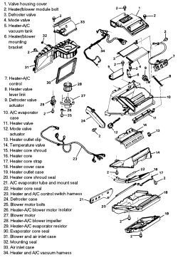

Trouble removing heater core from housing box in a 01 chevy cavalier
Monday, June 12th, 2017 AT 3:48 PM (Merged)
  • 108,192 POSTS
Take a look at the attached pic and let me know if it helps. It shows the entire unit in an exploded view. Hopefully, you can see something that needs removed.

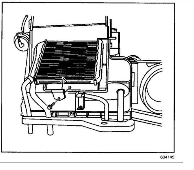

HEATER CORE AND RELATED COMPONENTS
https://www.2carpros.com/forum/automotive_pictures/261618_0900c1528003cf21_1.jpg

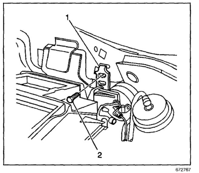

  • 108,192 POSTS
Here are the directions. Also, I have attached an exploded view of the system. I hope it helps.
Disable the SIR system.
Disconnect the negative battery cable.
Properly drain the cooling system.
Raise and safely support the vehicle.
Detach the heater hoses from the heater core.
Carefully lower the vehicle.
Remove the instrument panel. For details, please refer to the procedure located in Body & Trim of this guide.
Remove the DERM with the attaching bracket.
Detach the heater core cover.
Unfasten the heater core mounting clamps, then remove the heater core.

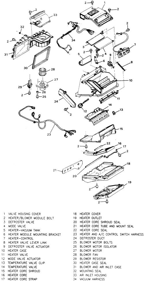

This is the only exploded view picture I could find of the system. I hope it helps. It shows the entire system.
