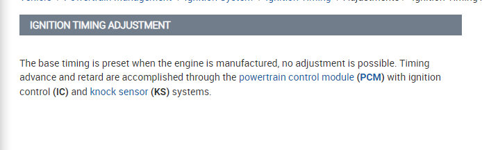

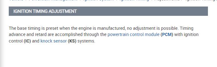

This could be a timing issue but this is all controlled through the PCM so even if it is, there is not adjustment.
However, if we have fuel and spark then we need to look at timing and go from there.
