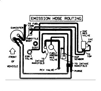

I have been unable to find a picture to see where all the vacuum lines connect. The sticker on the car is degraded and hard to read. Plus I have a hose that is not connected to anything and not plugged and another item that does not have a hose connected at all. Any help would be appreciated.

All i could find was Emission hope it is some help
https://www.2carpros.com/forum/automotive_pictures/198357_Grafic_3_52.jpg

I was the fuel pressure regulator like you said, runs good now :)
Thanks for your help.
