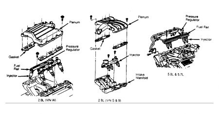

If you pinched off the hose coming from the pump and it still lost pressure, it's either a leaking injector or the regulator is bad.
As far as the injectors, on the V8, first disconnect the battery. Unbolt the fuel rail retaining bolts and injectors will come off with it. If you need to remove the injectors from the rail, there is a retaining clip. Just rotate it to the unlock position. NOTE: There are rubber O-rings on the injectors. Make sure not to damage them or you will create a new leak.
Let me know what you find. If you haven't checked the regulator yet, do that before going through removing the rails.
Here is a picture of the injectors and fuel rails. The V8 set up is on the right. Let me know if it helps.
https://www.2carpros.com/forum/automotive_pictures/249084_5_53.jpg
Sunday, August 22nd, 2010 AT 10:19 PM

Yes the injectors will be on the rail and the o-rings will be at the base of the injector. Once off, turn the key to the run position so the fuel pump builds pressure and check for any of them leaking.
As far as the regulator, you can check if it is bad. When checking fuel pump pressure, remove the vacuum hose and the pressure should increase around 5 to 10 psi.
Sunday, August 22nd, 2010 AT 11:55 PM
