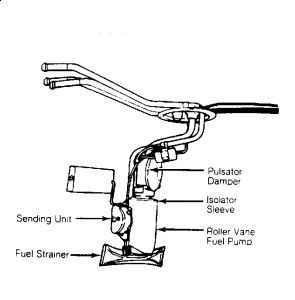

I need help getting started changing the fuel pump on my camaro. I don't know where to find the fuel pump. I need help changing it.

If you have fuel injection, and you do, your fuel pump is in the fuel tank. You need to remove the tank. Here is a picture of the pump:

Sorry, I hit the submit too fast. Here is the picture:
https://www.2carpros.com/forum/automotive_pictures/249084_fuel_filter_2.jpg

If you want to make it easier to change that in tank fuel pump you can do like I did, cut out a panel in the hatch area and fab one up to put back in so you can easily remove it for future problems.

That would work, but we recommend replacing it with a direct fit pump.

Sorry, should have clarified myself, cut a patch out of the hatch floor and not the tank, if you fab your own access panel in the floor it makes it easier, especially if you plan on keeping the car for awhile.
